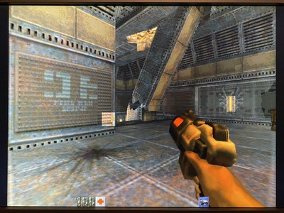

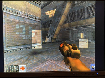

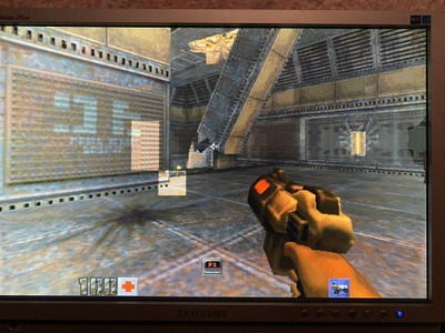

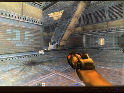

JustJulião wrote on 2023-03-03, 20:32:
Wow I've never seen this.
Can you play at a lower res. and tell if it changes something ?
Generally speaking, stay away from S3 cards for PowerVR gaming, it's among the slowest. Verite is fine.
Squares scale with different resolutions, so they definitely have the same size in pixels and yeah, these are tiles 😁
Will read PVR architecture reference to understand how it's possible (really, more likely I would have expected squares at a fixed point in the screen space than in 3D)
320X240
55.06 KiB
2064 views
512X384
57.42 KiB
2064 views
640X480
61.67 KiB
2064 views
1024X768
61.33 KiB
2064 views
Reply 1042 of 1104, by DigiMind
I have an idea.
Broken tiles are simply unlit ones. Don't remember how is lightmapping realized in Q1/Q2 engines, but this is a "multi-texturing" issue.
Not sure how can (for example) be broken part of the chip core (ALU, tile-processor etc.), so maybe after all this is VRAM issue.
Very fun glitch 😀

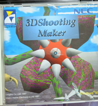

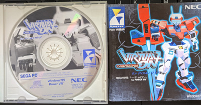

New toys for my PowerVR card
405.32 KiB
1951 views
149.05 KiB
1951 views
169.65 KiB
1951 views
I've only found videos of PS1 versions of Enigma and 3D Shooting Maker, none of PowerVR ones, so I'll make some gameplay videos sooner or later.
Unfortunately, 3D shooting Maker's menus rely on system fonts, meaning my american release of Windows can't display them corectly. I guess I'll have to install a japanese version of Windows.

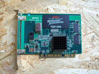

Bought a rare version of the PowerVR PCX1
