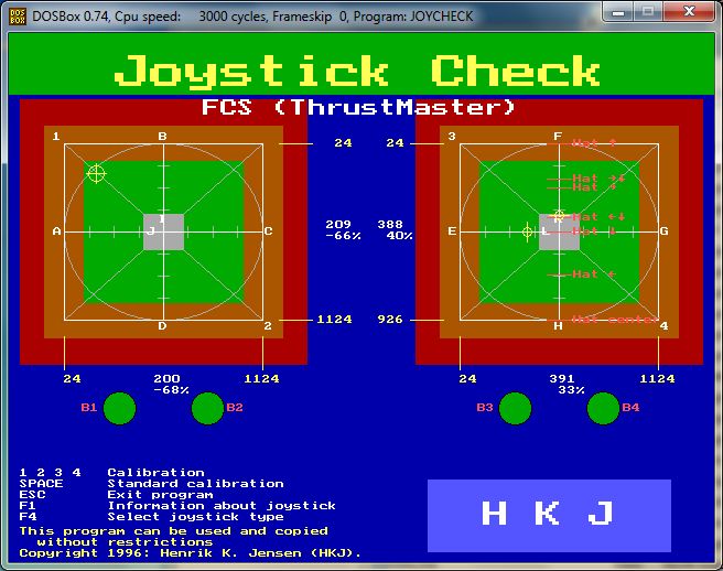

Reply 6 of 6, by susiapfelsaft
the WCS is an extra throttle for the FCS for a so called "hands on throttle and stick" setup.
i think that the HAT buttons on a FCS are implemented as threshold values of one of the Axis of the 2nd stick, thats why you sometimes have to change 3 and 4.
