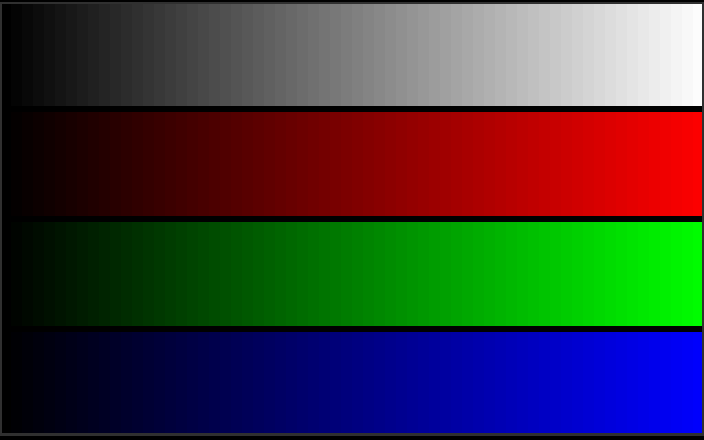

Since the new vgaonly mode with the scanline precision and all, the colors are no longer correct on my system. At least, I guess it is since version 0.74 because I have done a lot of capturing in the vgaonly mode and only recently I stumbled upon this error.
What happens in WINDOWED mode is: the red color channel is mapped to the green one, the green color channel is mapped to the red one, and the blue color channel remains black. So red is green, green is red, white is yellow (because of the lack of blue).
What happens in FULL SCREEN mode is: the blue color channel seems normal, but the red and green channel reach maximum brightness at half the range and then starts again. So when a single red or green gradient is displayed, it renders two gradients next to each other. It looks like if the red and green channel registers/variables are bit-shifted or rotated, or something like that.

Well, this is not Apple MAC (Intel) related, but it is DOSBox v0.74 "machine=vgaonly" relevant.
System:
Microsoft Windows 98 4.10.2222 A

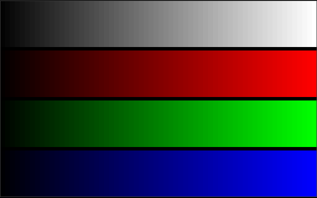

Noticed a color display problem with DOSBox v0.74 on a Win98/nVidia PC with the "machine=vgaonly" setting. This color display problem does not occur with DOSBox v0.74 and the "machine=svga_s3" setting. The error which occurs with "machine=vgaonly" is not influenced by how the [sdl] output setting is configured (ie, surface, overlay, opengl, openglnb, ddraw).
The DisplayMate (SONERA) Technologies video test programs DisplayMate for Windows and DisplayMate Professional for DOS were used to display a 64 intensities Gray-scale and RGB color ramp on the PC platform described above.
First, the Windows version of DisplayMate was used to display the color ramp test pattern on a 640x400 Desktop to check the nVidia Windows video drivers (v82.69) color display output on the nVidia FX-5950 Ultra, when a full-screen test pattern was captured. This can be seen in the attached file: DisplayMateWindows_64scale.png
Second, the DOS version of DisplayMate was used to display the same color ramp test pattern under DOS 7.1 from the nVidia FX-5950 Ultra VGA adapter, using the screen capture program PCXdump v9.32 for the test pattern displayed in VGA mode 0x13 (320 x 200 x 256 colors). The native 320x200 PCX capture file was re-sized to 640x400 when converted to the PNG format. This can be seen in the attached file: nVidia_5950U_VGA_DMP_64scale_resized_PCXDUMP.png
Third, the DOS version of DisplayMate was used to display the same color ramp test pattern under DOSBox v0.74 using the "machine=svga_s3" setting, which was captured using the native DOSBox CTRL-F5 screen capture mechanism for the test pattern displayed in VGA mode 0x13 (320 x 200 x 256 colors). The native 320x200 PNG file was re-sized to 640x400 when saved as the PNG format. This can be seen in the attached file: DosBox_074_svga_S3_DMP_64scale.png
Fourth, the DOS version of DisplayMate was used to display the same color ramp test pattern under DOSBox v0.74 using the "machine=vgaonly" setting, which was captured using the native DOSBox CTRL-F5 screen capture mechanism for the test pattern displayed in VGA mode 0x13 (320 x 200 x 256 colors). The native 640x400 screen capture file was saved in the DOSBox native PNG format. This file is the one which displays the the color and intensity problems of the "machine=vgaonly" setting of DOSBox v0.74. This can be seen in the attached file: DosBox_074_VGAonly_DMP_64scale.png
Fifth, the DOS version of DisplayMate was used to display the same color ramp test pattern under DOSBox v0.74 using the "machine=vgaonly" setting, which was captured using the screen capture TSR PCXdump v9.32 screen capture mechanism for the test pattern displayed in VGA mode 0x13 (320 x 200 x 256 colors). The PCXdump v9.32 TSR was used instead of the native DOSBox v0.74 CTRL-F5 screen capture method to see if the image captured from the emulated VGA frame buffer was actually correct. The video data captured from the DOSBox VGA frame buffer appears to be correct as captured by the PCXdump v9.32 TSR. This can be seen in the attached file: DosBox_074_VGAonly_DMP_64scale_PCXDUMP.png
Examination of the file DosBox_074_VGAonly_DMP_64scale.png shows that only the Green 64 intensity ramp appears to be displayed properly. The Red and Blue color ramps only appear to display 32 different color intensities as compared to the 64 Green intensities. Most apparent is the 64 intensity Gray-scale, which is not any longer a Gray-scale, as visible amounts of Red and perhaps Green can be seen instead of a smoothly progressive Gray-scale.
Contrast this above mentioned image with the comparison file DosBox_074_VGAonly_DMP_64scale_PCXDUMP.png which was captured with the PCXdump v9.32 TSR from the same DOSBox "machine=vgaonly" v0.74 session. This image captured via the PCXdump TSR appears to be correct, while the DOSBox v0.74 display and native CTRL-F5 screen capture output appear to be corrupt.
