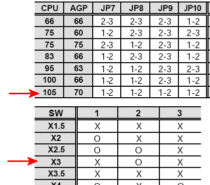

I have a Gigabyte super socket 7 mobo, with an Intel Pentium 233MHz MMX CPU in it. I have been reading the manual, and wondered if it's possible to overclock the system bus (and CPU) to 105 FSB? If I set the CPU's multi to 3x (from 3.5x), this should yield a speed of 315 MHz. I tried 100 FSB (3x multi), to get a CPU clock speed of 300 MHz, and it worked perfectly. I then tried setting the mobo's jumpers to 105 FSB, but the BIOS POST display still reported the CPU's speed as 300 MHz. Perhaps you must use an AMD K6 CPU, if you set the FSB to "strange" values such as 105 FSB? Any comments would be appreciated. Thanks.
BTW, there are two jumpers on the mobo I don't understand. One is "VCC3 Connector" (page 30), and the other is "VCC Voltage Setting" (page 31). Also, this Aladdin chipset based mobo has awkwardly placed capacitors around its CPU socket area. This means that it's not possible to use larger socket 370/A/462 heatsinks. Pity.

Reply 1 of 50, by Mau1wurf1977
Try a lower CPU multi (e.g. 2 or 2.5) and see if the 105 FSB setting gets going...
300 MHz on a 233 cpu is quite impressive!

Reply 2 of 50, by Old Thrashbarg
Random thought, but when you tried 3x105, did you check the speed with something like CPU-z, rather than just at the POST screen? It could be that it works fine, but the BIOS just wasn't set up to report odd speeds like that...
Honestly, that was going through my mind when I saw the BIOS POST screen report 300 MHz. Unfortunately, tiredness and laziness got the better of me, and I didn't allow Win98 to boot up to the desktop, for me to then run Sandra 2002 Pro and check this. (BTW, I don't think CPU-z runs in Win98 ?)
You were right. 😀 I've set the mobo's jumpers back to 105 FSB / 3x CPU multi, and although the BIOS POST screen reports 300 MHz, Sandra 2002 Pro reports the CPU speed as 315 MHz. And the system is stable! Initially, I used 3.2V for the CPU, but that produced occasional graphical glitches on the screen, and also occasional freezing. I increased the VCore to 3.3V, and that has cured those problems.
I ran a few benchies, and compared the results with some older 100 FSB / 3x multi: 300 MHz scores. The new 315 MHz scores were better. Obvious I know, but there's one problem I have ATM. Sandra 2002 Pro oddly reports that the FSB is running at 66 FSB. I don't think this is correct. It must be 105 FSB. Perhaps there is some kind of "communcations failure" between the mobo's BIOS and the Win98 operating system?
I've learnt 2 valuable lessons today. Firstly, the BIOS POST screen may not always tell you the correct speed of the CPU. Secondly, if you've been doing crazy overclocking, and the mobo subsequently appears to have died, remove the CMOS button battery. I'm not sure how long to wait, but I guess a couple of minutes at least. I think sometimes if crazy overclocking goes wrong, it messes up the BIOS. Removing its battery clears this "corrupted state".

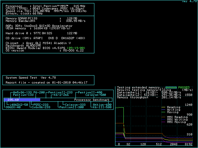

Reply 5 of 50, by retro games 100
The system appears to be stable at 315 MHz. (I used a vcore of 3.4v. I also set the BIOS settings to "fail safe".) There are a couple of odd things. Firstly, I stress tested the CPU by running SuperPi.exe. After the 1M test had successfully completed, the time given was about 8 minutes and 50 seconds. However, as can be seen in the image below, the 1M time is reported as 4m and something.
Ugh, I just noticed in the image that the CPU benchmark has been covered up by another window. Oops. I think the P233 mhz has definitely reached its limit, at 315 mhz. 333 mhz is far too much. I cannot get this speed stable at all. Overall, 300 mhz is a much better option, I think.
BTW, for the heatsink, I'm using the "slimline" copper cooler found on a Powerleap adapter! It just about fits, next to some awkwardly placed caps near the CPU socket.
Reply 6 of 50, by retro games 100
With the system at 315 Mhz, and the BIOS options set to "fast", DOS seems to work well. Doom, 3dbench2 (144.7 score), and Speedsys all work as they should. Like Sandra 2002 Pro, Speedsys also says that the bus is 66 Mhz.
