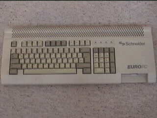

i have schneider euro pc , i change my 3,6 v battery on motherboard, but it seem don't rechearge...it is a rechearge battery???
the pc tell me:
RTC time or date error
RTC status correct
Video setup error and
memory size doesn't match
what is mean?

Reply 11 of 17, by jim78b
it is no so simple!!i don t hsve original ms dos !i put a 3,3 dos version .trouble is keyboard .bios don t save my qwerty keyboard and use default thath is gernany!i think problem to memorize in bios is for the video setup error?i put a vga in isa slot because i don t have cga monitor.
Reply 12 of 17, by jim78b
i post ni cadmio photos, yesterday i was happy the pc memory bios run perfectly!today it seems uncharched!!!why ??
i post photo where i solded the battery and his place on motherboard.

Reply 14 of 17, by Markk
I wonder, if you buy a battery like that new, if it isn't charged, wouldn't it require some time to do so? In my opinion it would be better to replace that battery with a battery holder and use either 2-3 AAs or a 2032 battery. And of course if you do that, you have to fit also a diode, so as to prevent it from charging the non-rechargeable batteries. If you fit a battery holder, you can take it also out of the case, and replace the batteries whenever you need more easily.

Reply 16 of 17, by Markk
No problem. AAs are these batteries :
and 2032 is this :
A battery holder, is a small thing that contains the batteries, and lets you connect cables on it.
or
If you do that, the batteries you are going to fit, should last for a year or more. The only problem you have then, is that you don't want the pc to recharge them. So you use a diode. A diode looks like this :
This small thing, just lets the electric current flow only on one way. So if you attach a diode on the positive pole of the battery holder, it will let the batteries power the RTC, but it will prevent the pc to recharge them. You must be careful with the diode, because it works one way. If you fit it backwards, it's going to charge the batteries, and they won't power the RTC.
