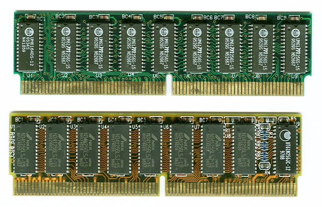

Could you post any part numbers that may be on the cache module that would make finding one easier? I have an M919 and need a cache module.
Reply 14 of 31, by BastlerMike
That is how they look... on the backside of the lower one it reads 'Elpina'.

To me they look not like fake. I could never test it. Once I had a M919 without the stick... i sold the board. Later I got a cache stick, but I no longer had a board... so I discarded the stick 😢

I noticed significant speed improvement with everyday office tasks when I inserted the 256 KB cache module. It was a real eye opener for me. I'd never want to use this board without cache again.
Surprisingly, I've found some of the cache modules work better than others. On some of them, they sometimes fail to report at POST. The image of the one I am including always shows at POST, cachechk and Speedsys both recognise it.
I use this M919 with 128 MB EDO ram on the fastest cache settings (2-1-1-1) and fastest RAM waits (0 WS). I can also turn on all Cyrix 5x86 enhancements (minus BP), which makes a big difference as I've noted in a previous post.

Regro Games, regarding that post, I think you have a winner. Try setting the L2 to Write-Back, power down, remove cache, power up, power down, reinsert cache, power up, resave BIOS such that L2: Write Back and check Cachechk and Speedsys again.
With my other cache module (the more flakey one), this is what I did and it worked.

feipoa, this is very interesting. Thanks a lot for the tip. I'll make a concerted effort to locate my M919, and retest it. Regarding your uploaded photo: it's exactly the same module I have!
