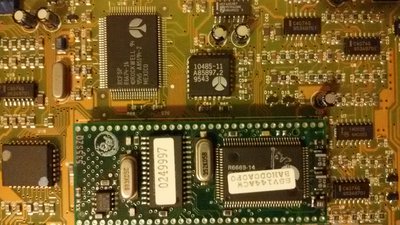

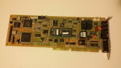

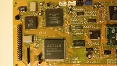

I got this Aztech sound card today, yet to find any drivers or test it yet though.
Is it any good...?

Reply 18 of 32, by jesolo
Is it any good...?
It's one of the Aztech combo cards, which had a modem and sound card on one board.
Your card appears to be using the AZT-2316 chipset, which was used on the 3rd generation Sound Galaxy sound cards (it's still a non Plug 'n Play card) - you should be able to use one of the driver sets of one of the 3rd generation sound cards. Check out Vogons drivers. There are driver sets for a range of Aztech cards.
The modem chipset appears to be a Rockwell. There's usually a model (chipset) number printed on the chipset. Once you know what the chipset number is, then you can just Google it. You should then be able to obtain a generic driver for it.
Is there a model number (FCC-ID) printed somewhere on the board? The picture isn't very clear. Will usually be something like I38-MMSNxxx (later models had an FCC-ID of I38-SNxxxx).
Reply 19 of 32, by turtlesedge
jesolo wrote:
It's one of the Aztech combo cards, which had a modem and sound card on one board. […]
Is it any good...?
Hey jesolo, thanks for the quick reply. There doesn't appear to be an FCC-ID on the board but there is a sticker on the back with a code "AZSC55010468". I have searched and still have no idea what model it is. I was hoping DOS drivers would exist for it.
