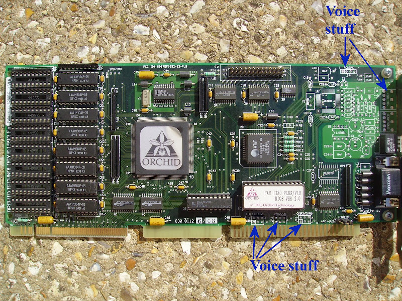

I am testing an Orchid Fahrenheit 1280 plus 1MB VLB VGA card. Underneath the card's Orchid sticker, is an S3 "S3C805" chip. This card can be upgraded to 2MB. The chips onboard have a NS speed rating of 50. That's quite fast, but unfortunately the card is very slow. I think it's an early VLB design. I don't think it's worth upgrading this card to 2MB. I am guessing, but I don't think a memory upgrade will speed it up, either in DOS or in Windows. I think it would just allow you to pick higher screen resolutions in Windows 3. It does have one good feature however. The general image quality is good, not blurry.

The card
Looks like they reused an older PCB design. I think one of Orchid's older models was called "VA". I am guessing that this was their "Voice Activated" video card.
Reply 2 of 5, by retro games 100
Hehe. In the help file, it says about the Fahrenheit VA card -
The Fahrenheit VA is more than just a Windows Accelerator--it features the
fastest graphics possible, with a twist! With Orchid's own Voice Notes
software, the Fahrenheit VA enables you to add custom voice annotation to
all Windows applications supporting Object Linking & Embedding (OLE). A
single keystroke opens the Voice Notes window, allowing you to easily
record, play, pause, and automatically embed your recording within the
document.
Reply 3 of 5, by Old Thrashbarg
Yeah, the '90s 'multimedia' craze brought out some... creative attempts by companies to set their products out from the pack. That Orchid VA card used the premise of adding audio to visual presentations and such. Because you'd apparently want to use your video card for doing that.
