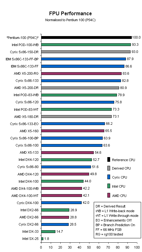

RESULTS - FPU
For non-overclocked CPUs, Appendix 6 indicates that the Cyrix 5x86-133 had the best FPU performance, whereby the Intel POD-83-WB was next in-line with 4% less performance. A Cyrix 5x86-120 and POD-83-WB were a close match, with a 3% lead by the POD-83-WB. A Cyrix 5x86-120, and even a POD-83-WT in write-through mode, outperformed the AMD X5-160 in FPU operations. Looking at the charted FPU results, an AMD X5-160 was approximately equivalent to a Cyrix 5x86-100 in floating-point operations, while an AMD X5-133, Cyrix 5x86-80, and Intel DX4-120 demonstrated similar performance.
For overclocked CPUs, the IBM 5x86C-133-FF-BP fell short of an Intel POD-100-WB by 5% and an AMD X5-200-RG fell short of an Intel POD-100-WB by 10%.
Observing just the three DX4-100's (Intel, AMD, and Cyrix), the Intel piece won by only a slight margin (2%) - the three were all basically equivalent in FPU operations. The same can be said for the three DX2-66 pieces; their performance deviated by less than 1%. Assuming all three DX2 / DX4 CPUs were available concurrently for purchase and there was a steep cost differential, the obvious decision would have been to buy the most conservatively priced CPU, that is, if FPU performance was the primary interest. In 1996, the main applications demanding FPU power were mathematical and simulation-based modeling for the scientific research community, as well as the newly released 3D game, Quake. Widespread mp3 decoding interest followed suite shortly thereafter.
Clock-for-clock, FPU performances of the Cyrix 5x86-100, Intel DX4-100, and AMD DX4-100 were 64%, 44%, and 42% of a Pentium-100 (P54C), respectively. Certain 3D games, such as Quake, make heavy use of Pentium-specific optimisations, so the FPU performance difference with Quake between Pentium vs. non-Pentium chips is expected to increase more than with other benchmark tests. Taking Quake as an example, and looking at Appendix 3, Test 47, we see that the performances of the Cyrix 5x86-100, Intel DX4-100, and AMD DX4-100 are 53%, 45%, and 43% of a Pentium-100 (P54C), respectively. As for the AMD DX4-100-WB, the addition of 8 KB more L1 cache, and with the CPU in write-back mode, did not seem to improve FPU performance.
When observing the Quake score of the POD-100-WB, it should be mentioned that this CPU was unable to complete the Quake timedemo test. This score had to be linearly extrapolated from the scores of the POD-83-WB, POD-83-WT, and POD-100-WT (not included on the charts). The fastest playable Quake score was from the POD-100-WT, which scored 23.6 fps. The POD-100-WB, however, was able to complete all other tests found in this report.
Looking again at the design enhancement factor for FPU operations, the AMD DX2-66 / X5-133 showed a DEF of 0.97, or a 3% loss, while the Cyrix DX2-66 and Cyrix 5x86-133 showed a DEF of 1.45. For the Cyrix 5x86-133, enhancements in CPU architecture (as compared to an old generation DX2-133) increased floating-point performance by 45%! Through linear extrapolation, the FPU performance of a fictitious Intel DX2-60 was obtained, resulting in an Intel DX2-60 / DX4-120 DEF of 1.0, or no gain/loss.
    15.06 KiB
    109513 views

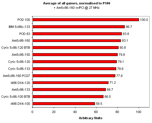

Fastest PCI graphics card in a 486
The motherboard used in these tests had a real 256 KB SRAM module installed. Speedsys and cachechk both report enhanced speed in the 16-256 regime. The performance of the M919 w/256 KB cache agrees well with results found on the Biostar MB-8433UUD motherboard. Both have the same chipset as well.
EDIT (13 Sept. 2018): Later work, which compares 486 CPUs using glide games on a 486, can be found here: Voodoo 1 vs. Voodoo 2 on a 486
A brief summary is provided for convenience:
7.97 KiB
56072 views
