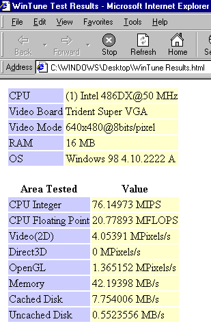

WinTune 98 - using Windows 98 with only 16MB of FPM.
