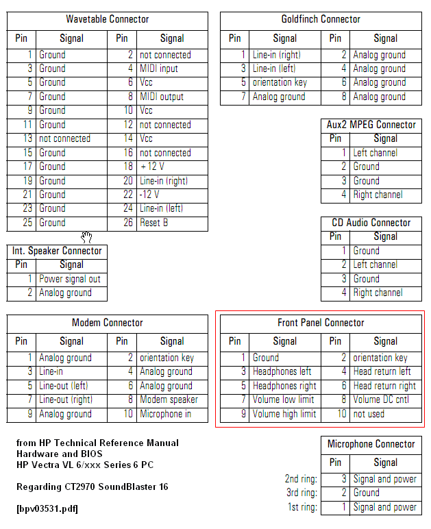

The normal unamplified Line Out of the CT2860 is noticable more noisy then that of the CT2800.
I found that the raw output lines of the CT2860 Vibra chipset go tot a 8 leg TDA8199 chip. Which is told to be a "Stereo Amplifier And DC Volume Control For TV". This chip is not found on the CT2800.
I don't know yet if this thing is always between the line-out of the CT2860, but if so it would mean there is no pure Line Out on this card. But either single or double Amplified.. That is bad. The TDA8199 has a volume control input which is routed to a pin on the Jumper block J5 nearest C93...
The sticker on the back of this card says this card is a HP part, as in Hewlett Packard maybe.
Edit: I traced the amplified output, pretty sure it is going through both amplifiers, so double the noise.
Also I traced the Line Out, it is going through the small amplifier too.

Yes I tried that. First by cutting the power to the first Amp. But after that I decided to totally remove the first Amp from the card. Either way the noise was much less and the card still works.
Still it gives a bit more 'computer' noises then the CT2800. So I will try to bridge it better.

Attached an image of the jumper block present on another HP card (CT2970). It is similar to the CT2860 jumper block. It is for a front panel connector.
    56.05 KiB
    6578 views
