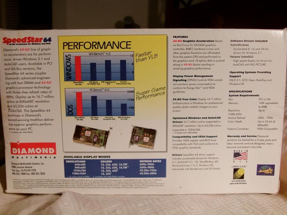

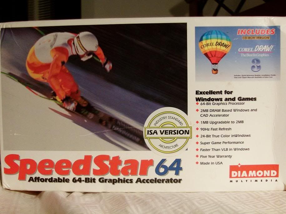

Reply 16 of 27, by dirkmirk
Okay here are the pics
I bought this card for $33 delivered to Australia from the USA, bargain!!! And I thought it was going to be a 1meg card so you can imagine my excitement when I discovered it was 2meg.
Reply 17 of 27, by feipoa
Those look like bed sheets. Are you sleeping with your retro graphics card?
That is quite a nice package. It is a little difficult to tell from the photo, but it looks like for a Diamond Speedstar 64 to work with 1024x768 at 64K colours in Windows, it requires 2 MB of DRAM.
Reply 19 of 27, by dirkmirk
Yes the card is 2meg and you need 2meg to run 16bit colour at 1024x768, As far I can tell the Et4000 has no advantage over this card in any area, I benchmarked Doom, Quake, 3dbench and saw no difference in frame rate (on the 386), Nothing else would be worth benchmarking/testing I dont suppose.
