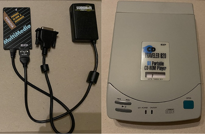

Thanks but what am I looking for in that link? I see a bunch of drivers but I don't see anything on that page about Sound Blaster emulation?
As for a PCMCIA sound card, there's a Wavjammer on eBay. Would that get me Sound Blaster sound?

You need the Audio driver there. If it's not installed on your laptop yet, of course. As I wrote my A31 emulates SB very well with this exact driver. https://thinkpads.com/support/Thinkpad-Driver … es/aftp1g98.exe
Yes, Wavjammer emulates SB in Windows. But the one that is for sale has no cable, so it's useless.
I also found Wavjammer SB emulation very noisy, it produces a lot of hiss and clicks.

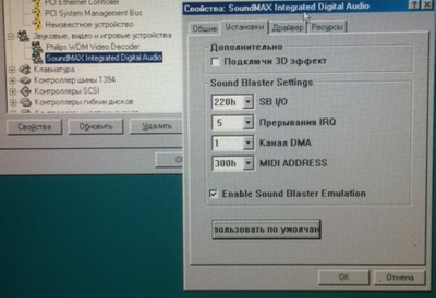

First you want to make sure that SB emulation is enabled.
Device Manager -> Sound devices -> SoundMax Integrated...-> Settings -> click Enable Sound Blaster emulation

Reply 332 of 579, by Guy With 3 Cats
Bondi wrote on 2021-02-04, 17:27:
Wow, good catch. It was unchecked so I checked it and rebooted.
May I ask what options I should be selecting in games now that it's checked?
Reply 333 of 579, by megatron-uk
Start off with the most basic "Soundblaster" - base 220, interrupt 5, dma channel 1 (or match whatever you set in the Soundmax settings). Most games should work with that, though you may miss out on stereo sound from Soundblaster Pro and Soundblaster 16 support.
If a game doesn't support Soundblaster, you can always try "Adlib", which is just the music/fm synth side of things.

Is there anything else I can try? I really really want to get this working 🙁
Edit: I just ran Wolfenstein 3D from inside Win98. For the first time it actually detected a SoundBlaster card! However, I am only getting sound effects but no music. Maybe this info helps in figuring this thing out?
Reply 335 of 579, by Bondi
Tested the EXP Multimedia kit that I bought NOS recently. Works flawlessly in DOS, does not require CS and SS if the PCMCIA controller is Intel 82365-compatible. But the stupid thing is that sound does not work if the CD-ROM is not connected. The driver just does not load, complaining that CD unit not found. I tried to use EXP Soundnote drivers and Argosy PCMCIA sound card driver - they don't work as well due to card ID mismatch, I guess.

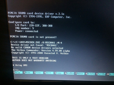

Reply 337 of 579, by Bondi
lolo799 wrote on 2021-02-08, 12:35:
That is weird, I had that exact card without the cdrom drive and sound was working fine with the S16 drivers.
Now that you wrote this, I thought that maybe S16 driver requires CS/SS drivers. I think I tried without them.
PCMCIA Sound Cards chart
archive.org: PCMCIA software, manuals, drivers
Reply 338 of 579, by Bondi
Maybe you had a different version of the card? Mine still does not work with S16 driver, neither with SC/SS nor without.
