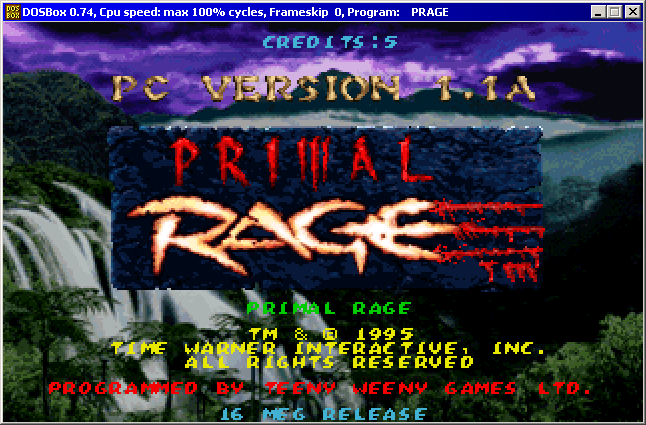

Reply 19 of 33, by ripsaw8080
Rank DOSBox Author
DOSBox Author
Al Unser Jr. Arcade Racing also needs cputype=486_slow.
I am running the 16MB version of Primal Rage version 1.1A in DOSBox 0.74 with default settings. Not seeing any memory errors.
