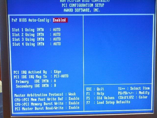

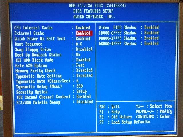

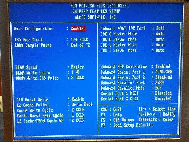

I have decided to post some BIOS screens with the settings I chose so if anyone cares to bother can look at them and correct me or suggest improvements 😀

Performance suggestions:
Pic 1:disable all the 'shadow' thingy
Pic 2:Disable 'auto configuration' and put Read:1WS and Write:0WS if your ram is 60ns,if 70ns set it to Read:2WS and Write:1WS; set parallel port mode to SPP, that gives less IRQ problems

thanks for these, I have enabled the "shadow thingies" because the instructions of UMB drivers insisted on them... will test without them
I will follow your suggestions and report on Monday with the results
and by DOS-win98-core I mean what AdamP wrote 😊

@sebaz_ri:
I did what you recommended and it actually was slower.... I use 4 identical 60ns 16MB simms and my RAM speed went from 24.26 to 22.04mb/sec ... I suppose "auto" configuration does use the optimal settings... cpu score was the same, 50.12

@keropi
Post a pic with the 'auto configuration' disabled
the speedsys 4.70 'memory speed index' is not in mb/s please use ver 4.78

@sebaz_ri:
I am currently using version 478, the pic on the first shot is from 4.78 (sst478.zip)
When auto configuration is disabled all that changes is the DRAM SPEED that I can go to "fastest" but the machine will hang on IDE detection (60ns fpm simms used) , all other values are already on the lowest from auto... well I don't really expect much from a SiS mobo 😁
