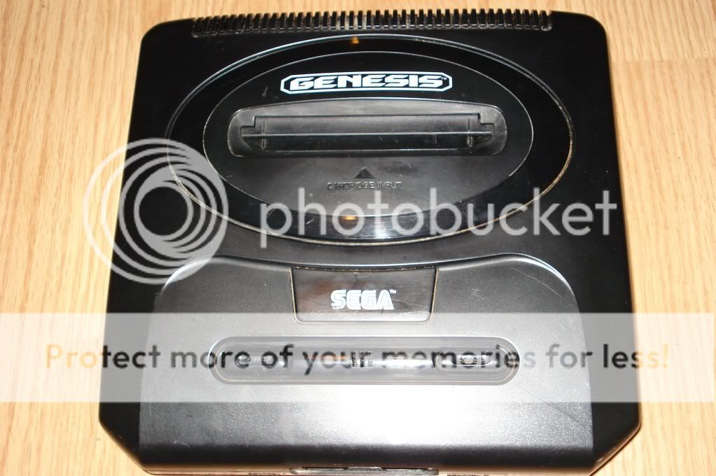

Actually, there were 3 Sega Genesis models released in North America.
Model 1
Model 2
Model 3
The Model 3 is an extremely cost reduced model that had some of the cartridge port pins disconnected so you couldn't use 32X or the Power Base Converter and there was one game that required one or more of the disabled pins that won't work. It also didn't have the expansion port that the Sega CD required so you can't use that either.

Yeah I have a Model 3 as well, honestly it's pretty nice for just carrying down to the family room to play with a friend instead of lugging my Model 1, or even worse my Model 2/SCD/32x monstrocity 🤣 People hate on it for its lack of compatibility, but I got it for $10 and it's convenient. Plus it actually has a really clean video signal compared to my Model 2.
