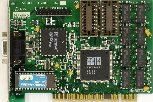

The ARK2000PV was liked by Computer Gaming World too, for DOS gaming. One of the fastest scores apparently.
Diamond Stealth 64 Graphics 2001

Reply 17 of 59, by NJRoadfan
Never knew Diamond made a card with this chip. By the time I got a card with it, I thought it was some obscure off brand chip nobody used with horrible driver support. XFree86 support seemed half hearted. I remember having to specify the RAMDAC on the card, plus do some crazy mode lines settings in xf86config to get the card to display anything higher then 16 colors!
