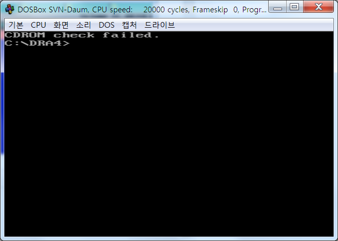

This DOS CD game is famous japan pc-9801 game "DRAGON KNIGHT4" which officially released in Korea. Nowaday this game is well emulated in pc-98 emulator "Anex86" or "Neko Project". But this CD image is pure DOS application with censored graphics and korean translation. I bought this game a few years ago but never played because after I installed and run, this CD always emit such annoying message.
http://cfile270.uf.daum.net/image/174841434FF4342931B396

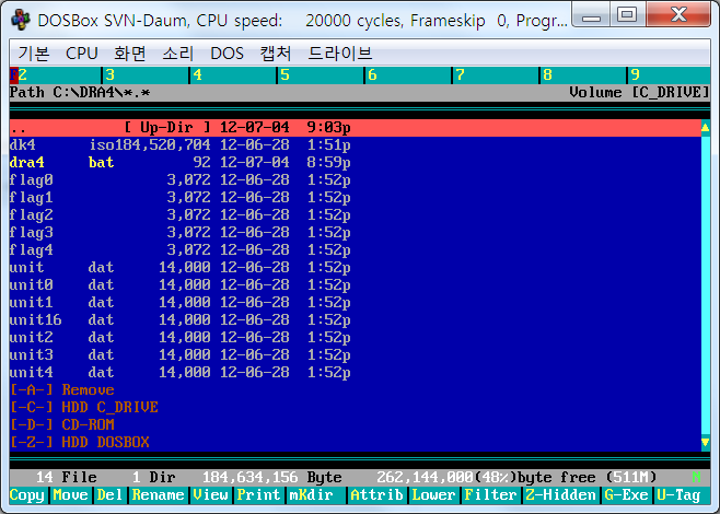

after install, game directory
http://cfile289.uf.daum.net/image/184132384FF433200814E0

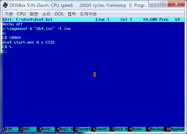

my CD mount method
http://cfile290.uf.daum.net/image/146617414FF433940C6781
I also tried installing real cd and mount physical CD-ROM but in vains. Always I found fuging "CD-ROM check failed"

There is a minor compatibility issue. The game's highly sophisticated CD check is to try and delete a file on the CD, expecting an "access denied" error.
The unlink function in drive_iso.cpp sets the DOS error to "access denied", but it is changed to "file not found" in dos_files.cpp:
bool DOS_UnlinkFile(char const * const name) {
char fullname[DOS_PATHLENGTH];Bit8u drive;
if (!DOS_MakeName(name,fullname,&drive)) return false;
if(Drives[drive]->FileUnlink(fullname)){
return true;
} else {
DOS_SetError(DOSERR_FILE_NOT_FOUND);
return false;
It seems that a good way to fix this is for all drive unlink functions to set appropriate errors, as is already being done for CD images.
