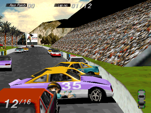

Trying to get this version of the game to run. The first error I encountered was that I got "No Diamond Stealth 3D 2000 detected". This is not uncommon as I don't have a Diamond Stealth 3D card, but a generic S3 Virge DX card. So to get around it I installed the Diamond Stealth 2000 drivers, and that worked in Windows mode.
The next problem I encountered was that I got a "Incorrect CD in drive", which baffles me since I have the original CD in my "D:" drive.
(Image of the CD here: http://dl.dropbox.com/u/57506833/vogons/s3dd0002.JPG )
Have I missed something obvious on the CD check somewhere? This version is Windows95, not DOS as the retail version. I've tried the No-cd cracks for the DOS version, but they don't work.
Anyone else have this version and can help? My theory is that since I'm trying to fool the system with the drivers, something goes wrong and I get this error up. Would be nice if someone with the actual card could test it out.

Well, thanks to archive.org I found the problem:
http://web.archive.org/web/19970414161115/htt … d-2000.html#1-6
After I install the Destruction Derby game and run it, I get the "Start up error" message "Incorrect CD in drive." What's going […]
After I install the Destruction Derby game and run it, I get the "Start up error" message "Incorrect CD in drive." What's going on?
Due to a manufacturing facility issue there was a bad production run of the Destruction Derby/Descent II discs. This results in the the improper validation of the cd. And it only surfaces when Destruction Derby is run.
If you receive this message, check the manfacturing coding on the inner ring of the disc. There will be a string of numbers preceded with the "ADCA" designation. This will verify the a bad disc.
To resolve this issue contact Diamond's Customer Service Dept. for a replacement disc. Please all 800-468-5846 or 408-325-7100 Mon-Fri, 6am-5pm (PST).
So I have a bad production run disc.. great. I know you leileilol and megatron-uk have a copy, would you be interested in helping me out?
My ADCA code: 10966 - 3 7 (8068) 75000117001

I got the game running!
It definitely looks alot better in S3 mode than in normal DOS! Higher resolution and filtering 😀
The executable that leileilol provided didn't work straight out of the box, so I thought I should give it one more go at the NO-CD hacking. I got it running, but it's not perfect at the moment. I still get an error that says "NO CD detected in drive" and there is no CD audio. I need to work on that to see if it's possible to get it back into the game. Also I noticed that using the generic Windows S3 Virge DX driver the game had some lag and FPS issues. I switched to the Diamond Stealth 3D 2000 PRO driver (made for the DX version which I have, though I don't have a Diamond card installed) and it ran alot better. I can confirm that my hack to remove the driver check does work without any issues, but it looks like this game has been optimized for the diamond drivers.
I also have another problem, the game runs at 512x384. My monitor reports: 1024x768 (which is bollox) at 56.3kHz running at 70hz. If I can't get it to run at 60hz or 75hz, then it will be a problem to capture some video footage as both my VGA capture card and my HDMI scaler doesn't sync with it.

btw, I definitely have better framerate with my DX card and 1ghz P3 than what he is reporting.
    186.54 KiB
    9434 views
    Destruction Derby on the S3 Virge

I did the hex edits to my original bad production run disc as well. It worked ,so it is not the .exe file that is the problem on the bad disc.
I have included two .exe files here, first one just removes the Diamond Stealth 3D 2000 driver check and lets the game run on any S3 Virge card, the second is a NO CD crack to the game. It makes the game run even if you have a bad production disc. I was unfortunately not able to crack the CD check and still keep the CD audio. Those with a bad production run disc are stuck with running the game without the music which is not optimal. The NO-CD file also removes the driver check.
filipetolhuizen: Refreshlock and Powerstrip did not work, also I can't get the game to run in Windowed mode. The only way I was able to capture some video was through screen capture software, but there I only got 5-10 FPS. If anyone know about any good capturing software (for Windows) that lets you capture in 30 fps please let me know. Fraps does not work.
