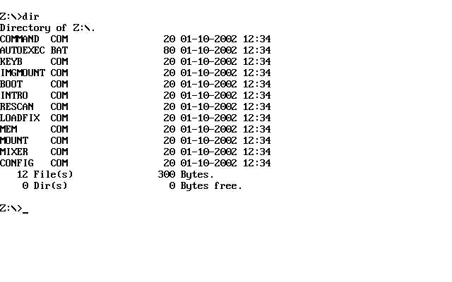

Can dosbox be started with a white screen?

Reply 2 of 3, by VileR
You can run the attached TSR from [autoexec]. The parameters for black text on white would be
CHGCOLOR 0:63 7:0

Reply 3 of 3, by joeyc100
Apparently just working in MsDos using an int10h function10h will allow me to set the bkg palette color to whatever, but only in regular video modes(640x480) and not in int10h function4f Vesa modes (1280x1024). And so the problem is not with DosBox running in Windows XP but with my program itself. I need the higher resolution with background colors.
