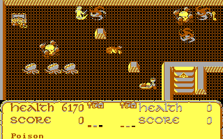

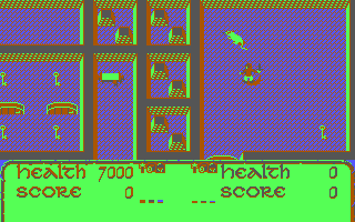

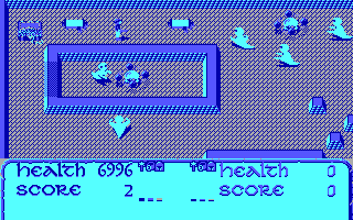

Reply 9 of 23, by Cloudschatze
VileRancour wrote:
With DOSBox set to machine=tandy, the game seems to use the usual 16-color Tandy mode (visually equivalent to EGA). So that's not how it works on an actual Tandy1k?
It works fine in 16-color mode. I'm referring to the 4-color CGA mode, however (set with the "c" command-line switch).
Reply 10 of 23, by VileR
Oh. That doesn't work in DOSBox 0.74, but it's been fixed since then (see attached screenshots from newer SVN builds).
Not sure why they'd do that when the Tandy already supported 16 colors... maybe some really low-RAM models couldn't handle the extra video memory overhead?

Reply 11 of 23, by Cloudschatze
Ah, excellent... 😀
It's not Tandy-specific, mind you. While the game isn't playable, I get those same colors in a system with an Accumos, AVGA1-based chipset. I'd be curious to know if it's more of a non-IBM CGA feature, or if the full palette register might have been implemented in later IBM cards?

Reply 14 of 23, by sliderider
Looking at those pics hurts my eyes. How the hell did we ever sit in front of CRT monitors with crappy refresh rates for hours at a time back in CGA days without going blind?

I'm not sure exactly what's with the tweaked colors on Demon Stalker. It seems to be intended as Tandy support, yet the game already runs in Mode Bh. May have been for some oddball CGA clone card or perhaps for users of older Tandys that didn't have have the 384k required to run it in 16 colors.
