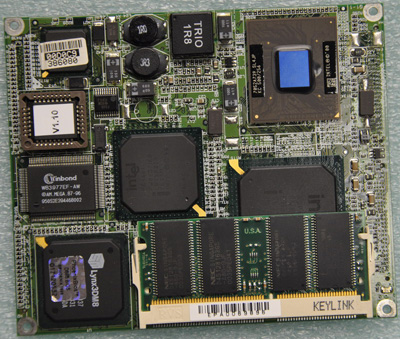

Reply 9 of 10, by gerwin
See attachment,
It does not get any smaller then this, 440BX, P-III 500..700MHz, 128MB. But no PCI/ISA, not even a 12 Volt rail, so not a real option.
Oh wait the PDF does mention PCI and ISA.
    SOM-4470_ds.pdf
    198.42 KiB
    88 downloads
    SOM-4470 Pentium® III SOM-ETX w/VGA, LCD,
    Audio, Video & LAN
    139.81 KiB
    1092 views
    SOM-4470F
