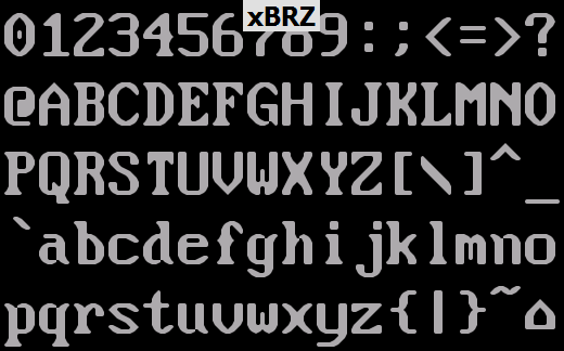

Reply 2 of 109, by VileR
The best way to get your code reviewed/tested would be a patch (diff) against clean SVN, rather than the whole source tree with the save states thing mixed in.
I'm not a huge fan of this type of scaling (prefer the CRT-like shaders myself), but I like what it does to text mode. This would be nice as a truetype font...
