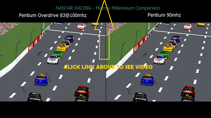

The Pentium 90 is about 10-15% quicker compared to my POD system with no L2. If the POD had L2 cache it should be pretty much equal except for PCPBench which just runs ALOT quicker on the P90 if solely looking at these benchmarks.
You also have to consider that running the FSB at 40mhz on the 486 board puts a 2/3 divider on the PCI bus, slowing it down to 27 mhz (which also happened with feipoa). This means that the Matrox and NV1 will run at a slower bus speed than the VLB bus which runs at the overclocked 40mhz. The Pentium 90 runs at a 60mhz FSB, which gives 30 mhz PCI, so it isn't running at full speed either.
So what do you think? Should I run the PCI video cards with the 486 board without L2 cache and slower PCI bus? Or should I compare the 3D Blaster VLB (running with the POD 100mhz with L2 cache) directly against NV1 & Millennium on the Pentium 90? Remember that the Matrox and NV1 was designed for Socket 5 and 7 systems and not late 486 systems with PCI. There also seems to be something fishy going on as the difference between the two systems in NASCAR Racing is very noticable. Maybe L2 cache is really important in this game? If it only were 1-2 FPS like in Quake and Doom I would not have made this thread, but when I see NOTICABLE difference between the two systems in NASCAR Racing running on the Matrox Millennium I have to ask what I should feature in the video. Check for yourself in this short clip: http://youtu.be/wirXtDmkJzY

As seen in the video clip the differences between the P90 and POD are noticeable in the accelerated Matrox version of NASCAR Racing (much more than in any other benchmark or game I've tried!).

I also captured a new video showing my VLB system running in SOFTWARE mode against the Pentium 90. Beside the OBVIOUS VGA output quality differences between the S3 Vision card and the Matrox Millennium the systems are very similar in terms of performance. Only point were they really differ noticeably is at 0:40 in the video. Here there are alot of graphics being processed and I can imagine memory throughput and/or video bandwidth playing a factor.
NASCAR Racing in SOFTWARE mode on Pentium Overdrive (in VLB system) vs Pentium 90:
http://youtu.be/uqf9BXmpW74

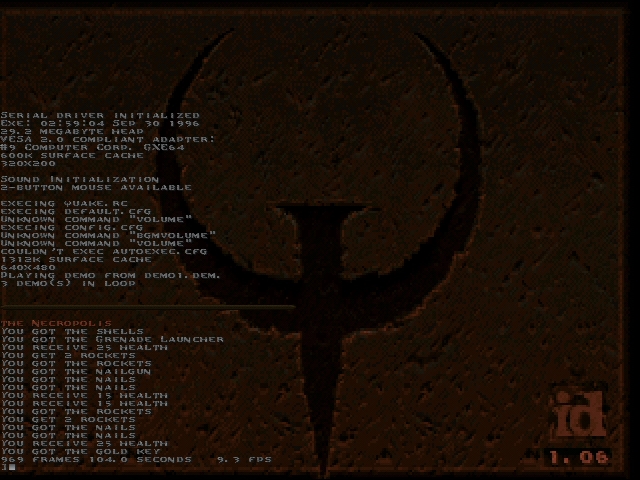

feipoa wrote:
I am surprised you were able to run your POD100 in Quake1's timedemo. That was the only test I had to chill the POD prior to testing to get a successful completion. All other DOS and Windows benchmarks could be completed with out prior chilling. Only 1 in 3 of my POD's run well at 100 MHz, but it sounds like your POD runs even better than mine at 100 MHz.
While doing some testing to see if I could improve the results even more with BIOS settings tweaking Quake crashed. I presumed that was because I had put some setting to tight, but when you write this then it actually may have been the CPU. I will need to do some more prolonged stability tests to see if it really is an issue.
