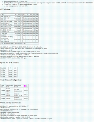

I too have the same revision of the TM-486SPS (identifiable by the letter "J" instead of "JP" for jumper designators, and no visible version in silkscreen).
Why I revived this old thread: I found the jumper settings after a painstakingly long search, and this is one of the first searches when you google this motherboard - and it never got resolved.
Please see attached. The only thing to watch out for is that the J12 column in the table is not correct. Refer to the footnote for J12 instead, as it is correct.

I'll just necro this old topic to thank @gloomkeep for that jumper guide. As I have the same board and I'm planning to set it up with an Am486 DX2-80, the manual on vogonsdrivers is indeed not the right one for our version:
