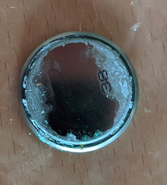

Reply 280 of 420, by imi
also not a SC55 but I guess this is still the best thread for it... I pulled this off a 486 board today
so yeah CR2032 lithium cells can definitely leak it's not just the SC55 ^^ this one was from toshiba.

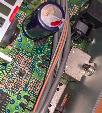

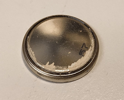

Reply 285 of 420, by BraveToaster
I was lucky enough to get an SC-55 MkII for a reasonable price (under 110€ including shipping), and thanks to this thread, I opened it up and checked the battery - and sure enough, the battery was leaky. That was a quick fix.
However, I noticed that one of the larger capacitors leaks as well, the one close to the heat sink near the back. I'm certainly no hardware electronics repair person, but I probably have to find someone to get that replaced before it kills the device. 😒
EDIT: After reading through the whole thread, it turns out that the brown stuff is most likely glue, e.g. here: Re: Have you opened your SC-55 to check the battery inside?
However, the residue at the top of the capacitor still looks a little suspicious, plus it looks like it's slightly bulged. I'll at least know to keep an eye on it.
Regarding leaving the battery out entirely, I've noticed the following: After I had it open and replaced the battery, it stayed completely silent. Demo songs still worked, but no MIDI signals arrived anymore. I then tried the secondary input (front MIDI connector) and that worked fine. I found Real sound canvas 55 MK2 midi in problem on Vogons, but it wasn't a connection problem. After fiddling with it a bit, I noticed that I had to swap MIDI-1 and MIDI-2 in the menu, and for that setting to be sticky, i.e. for MIDI-IN1 on the back to keep working, I need the battery. It's quite surprising behavior, but that's how my unit operates.
