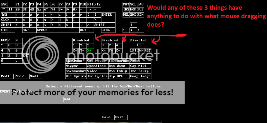

Okay so I managed to successfully map my movement keys to WASD as it should be (Using both left and right ctrl to do this). However now I need it so when I drag my mouse to the left it turns left and to the right it turns right. Is there an option for this?
Currently to turn right I would have to click the right arrow and to turn left I have to click the left arrow (these arrows to turn don't work now since I managed to successfully map my movement keys)...

Here is what you may consider a sad fact: Without some changes to DOSBox itself, no mouse can be involved in the mapping at all. Not the real mouse, nor an emulated one. Basically the real mouse is *always* mapped to an emulated one (and it's the only one which is mapped).
These numbers and directions you see in the UI refer to (emulated) joystick controls.

There is no way to remap a mouse axis to a keypress using solely DOSBox.
You may be able to accomplish this by modifying DOSBox and SDL sourcecode. (Your requested feature may not work easily with SDL.)
You may be able to accomplish this with an AutoHotkey script. General suggestions on where to look.

Alright I posted my query on the autokey forums so hopefully I can get a response there or at least figure out how to write the script myself. Thank you all for all your help I appreciate it!
