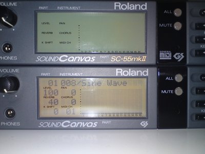

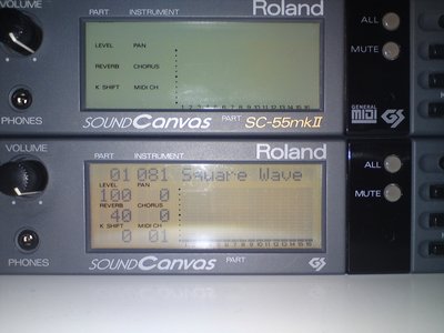

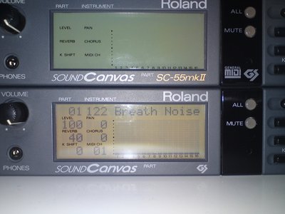

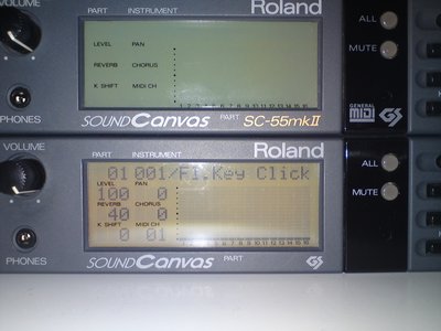

today I received a 2nd GS-only SC-55 for my builds. Naturally I tested it and found that the 2nd unit is a GM-compliant one, with Breath Noise and all 😲
On the following pics:
the upper unit is the "real?" GS-only unit with a serial of AC93519
the lower unit is the the one I just got, with a serial of DD61319
Here is a pic of Duke Nukem 3D level 1-06:
and here is tilakat's Descent2 mid (d2b.mid , stock game midi AFAIK)
and here is the same midi patched to play the Fl. Key Click instrument on GM units - the upper unit plays nothing on channel11:
I have tested Capital Tone Fallback feature in both units with unpatced/unmodded World of Xeen installation, arrow sounds play fine after you shoot - start walking - shoot again when you first load a game.
In DN3D and in tilakat's Descent 2 midis, the lower unit behaves like a GM-compliant one as you can see from the pics.
Anyone here has more info on this? Maybe some other test , something to show the version of the units? Or maybe this is just a GS-GM mobo in a GS-only case... (although it really seemed unopened, the roland tier ups etc, where unharmed) 😵
As always, any extra info/thoughts would be appreciated 😀

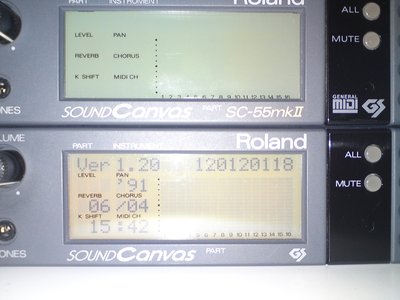

Reply 3 of 201, by keropi
more details:
following Roland's instructions to find the rom version:
SC-55/55MKII : Press the POWER button to make the STANDBY light come on. While holding both
INSTRUMENT buttons, press both MIDI CH buttons
I get these results:
Reply 4 of 201, by keropi
OK, more findings... I have opened both units to inspect them.
As expected the control rom is different , R15209275 9126D (1.10) vs. R15209363 9152D (v1.21)
Also IC30 is different: R15199736 (old) vs. R15199778 (new)
The 3 ICs that hold the samples (AFAIK) are the same part numbers: R15209276 , R15209277 and R15209281
old v1.10
new v1.21
I have tried swapping the control roms, it did not work. Both units just power on with the screen completely OFF and both ALL+MUTE buttons lighted.
Maybe the newer IC30 has the ability to load the extra samples from the Control ROM, assuming that the 3 sample roms are indeed the same.
Ofcourse all that is pure speculation from my side, I thought it worth the shot to swap control roms and see what happens 😊

Reply 7 of 201, by Great Hierophant
I did the test with my GM/GS SC-55, and I got a Ver 2.00 ROM with a '92 date. I checked inside and the three sample ROMs match Keropi's, but IC30 on mine is R15199799 and the control ROM is marked R15209387, 9224D.
I wonder if Keropi's 1.21 unit will respond to a GM System ON command, or if it just has the instruments of the later GM/GS units.
If you want an truly early SC-55, you probably will need to purchase a GS STANDARD marked unit.

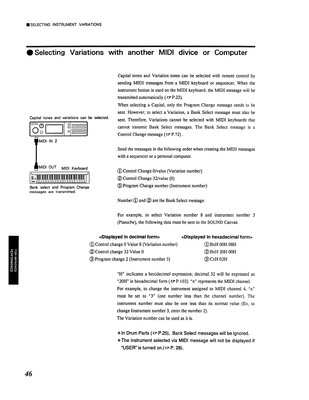

To me, it seems that the first units of SC-55 are a mix up of unfinished GS and GM standards.
SC-55 in GM mode ignores the CC0 BANK number and obeys PC (patch change) no matter what.
Obviously, there is no Bank number besides 0 (capital) in GM.
When a new GS device receives a PC message:
The device first checks the the CC#0 in memory at that channel and only then triggers the PC command.
Each of the 16 channels have a memory for CC#0 and CC#32 (SC-88 and up), so you can send a CC0 and CC32 to any channel independently from the PC command.
If the combination of CC#0 and PC does not have a match, the bank+patch request is ignored, and the tones doesn't change.
The CC#0 for that channel remains in memory till a different CC#0 is requested, independently from PC.
Manual: "Bank Select" is suspended until receiving a "Program Change".
Therefor CC#0 is in memory (per channel) for SC-55 or SC-55 MKII.
The old SC-55 (with CTF) is different:
If there is no match, it will ignore the CC#0 stored in memory and obey the PC request, just like GM would.
It's not actually a "Fallback", rather a Patch has priority over a Variation (Bank+Patch) mismatch.
This happens only in GS mode, most games use GM mode, so switch to GM mode before playing games to ignore CC#0 (if there is even a chance it exists in a GM game).

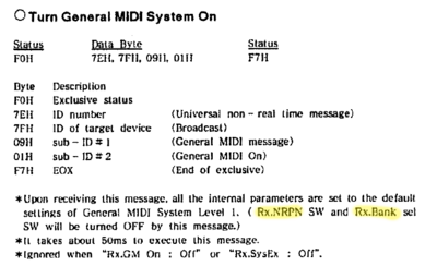

Reply 17 of 201, by Cloudschatze
James-F wrote:
The silence part is not true.
For now I can tell that SC-VA plays the previous instrument if changed to non-existent tone, instrument or drums.
I wasn't aware that this behavior had changed, but it looks like it did with the SC-88Pro and above. The silence statement absolutely applies to the SC-55mkII and SC-88 though, as you'll soon discover with your own SC-55mkII. (You can read about it in the manual in the meantime even.) 😀
When an SC-55 receives a GM System On message, it either:
1. Treats it exactly the same as a GS Reset (ver. 1.xx SC-55), or
2. Treats it as a GS Reset, but also sets Rx.NRPN to "Off." (ver. 2.xx SC-55)
That's it.
No SC-55 ever disables reception of the Bank Select when receiving a GM System On. That behavior was first implemented with the SC-55mkII.
Reply 18 of 201, by James-F
31.38 KiB
9503 views
You forgot Rx.Bank "Off for MKII...wait a minute... V2.xx is not MKII?
Is that a fact?
Do you experience this kind of behavior with your unit?
I don't see anything about silence if the bank is wrong anywhere in the manual.
672.58 KiB
9501 views
Reply 19 of 201, by Cloudschatze
That's correct. 😀
Is that a fact?
Yes, I've tested and experienced the behavior on my own unit. 😀
Page 67.
