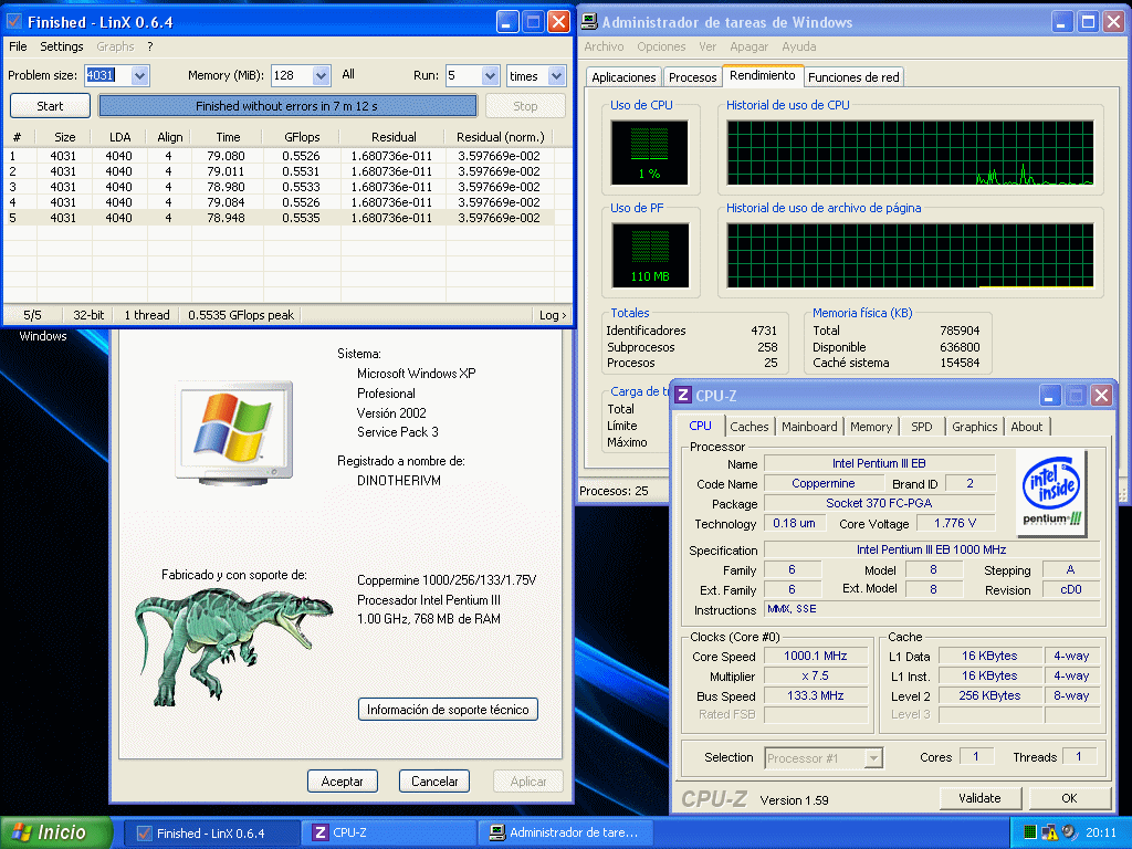

LinX results for my 2009 Compaq Mini netbook, behold the "awesome" performance 🤣 .
Yeah, really. That benchmark run 12 minutes and 11 seconds, so the N270 is really a dog after all. That would place it somewhere close to ... a 600 Mhz Pentium III with integrated graphics. That is something made in 2009. The Atom is no Pentium 4 folks, the Pentium 4 3 Ghz Northwood that formerly belonged to me and now is used as an office PC runs circles around it. The Atom is just a piece of shit, that's what it is.
And this is on mainline power, not battery.
