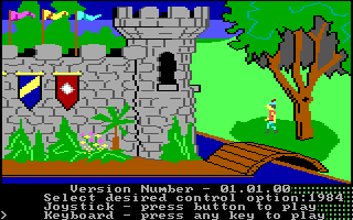

Reply 1 of 26, by collector
I did not check that many, but it did happen with the KQ2 booter. DDPG booter in tandy failed to start for me as well, but does work properly in PCjr. KQ1 booter works OK in PCjr. I can try more when I get some time. One other thing I noticed is the screen capture crashes DOSBox. The following capture of KQ2 was done with the print screen.

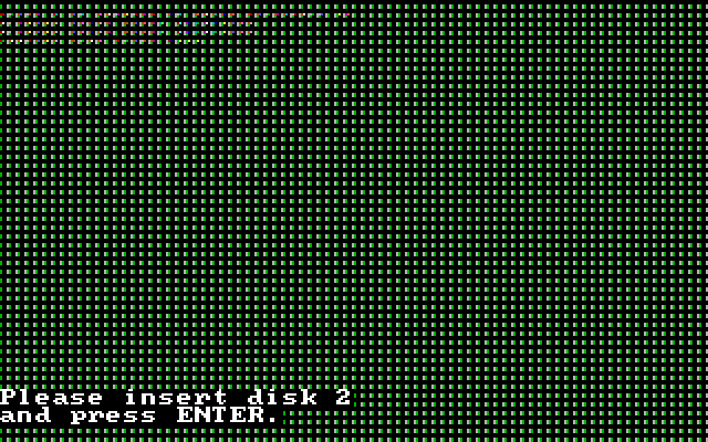

Confirmed! All I need to do is set the machine type to pcjr and boot the game. Now here's some interesting facts... Found another regression. You only get the green dots in the Tandy version only. Text remains on the screen but you can still play the game. Also it doesn't crash for me when I try to take a screenshot for King's Quest 1.
5.31 KiB
2709 views
Tandy version (machine=pcjr)

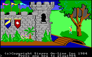

Now here's the weird part. In the IBM PCjr version of the game I don't see and dots. The text is still on the screen and it's not refreshed. But on top of that I can't play the game. You can type stuff in but you cannot move! I'm pressing the arrows but it doesn't work just like in 0.74.
5.01 KiB
2709 views
IBM PCjr version (machine=pcjr)
