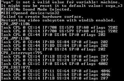

It seems like the C_DYNREC define is set to 1 during the ./configure step, so that's why it was enabled. I tried using the x86 CPU core and then the normal one, and I wasn't seeing any difference in results. I even tried to remove the -O2 compilation optimization, but that didn't seem to help either.
I ran this application in a Windows compilation of DOSBox with no problems, but the Linux version is much more unreliable. See the attached image of the task switching that occurs in the Windows version consistently. However, in the Linux version, sometimes I get the CPU_Interrupt 1st or 2nd. When it happens first, that is when the system crashes:
CPU_JMP:1106 Task CPL 0 CS:14 IP:20A9 SS:3D9 SP:A0 eflags 7206 Task CPL 0 CS:14 IP:20A9 SS:3D9 SP:A0 eflags 7297 Task CPL 0 CS:4 […]
CPU_JMP:1106
Task CPL 0 CS:44 IP:0 SS:84 SP:0 eflags 202
CPU_JMP:1106
Task CPL 0 CS:44 IP:BD SS:84 SP:0 eflags 212
Task CPL 0 CS:14 IP:0 SS:24 SP:0 eflags 202
CPU_Interrupt:795
Task CPL 0 CS:14 IP:1B SS:24 SP:0 eflags 297
Task CPL 0 CS:1C IP:0 SS:64 SP:0 eflags 4002
CPU_IRET:872
Task CPL 0 CS:1C IP:11 SS:64 SP:0 eflags 4002
Task CPL 0 CS:1C IP:11 SS:64 SP:0 eflags 4046
CPU_JMP:1106
CPU_Interrupt:795
Task CPL 0 CS:44 IP:98 SS:84 SP:0 eflags 212
CPU_IRET:872
CPU_JMP:1106
CPU_Interrupt:795 Task CPL 0 CS:14 IP:2272 SS:3D9 SP:9C eflags 7297 Task CPL 0 CS:14 IP:2272 SS:3D9 SP:9C eflags 7297 Task CPL 0 […]
CPU_Interrupt:795
CPU_IRET:872
terminate called after throwing an instance of 'char*'
So, as you can see, after that last example, when the Interrupt happens before anything else, the system crashes.
For understanding the print-outs, there are lines that are equivalent to "__FUNCTION__:__LINE__" (where __LINE__ is right before the CPU_SwitchTask() call), and then other lines that start with "Task" are...
LOG_MSG("Task CPL %X CS:%X IP:%X SS:%X SP:%X eflags %x",cpu.cpl,SegValue(cs),reg_eip,SegValue(ss),reg_esp,reg_flags);
...uncommented from the bottom of the CPU_SwitchTask function and then added to the first line and after the FillFlags() function. So, basically it looks like this:
bool CPU_SwitchTask(Bitu new_tss_selector,TSwitchType tstype,Bitu old_eip) {
FillFlags();
Any ideas?
I didn't get a chance to test using the latest copy from SVN, yet. Do you think this issue has been fixed?
-Corey
    14.61 KiB
    1567 views
    Windows consistently

Task CPL 0 CS:14 IP:3A83 SS:3D9 SP:9A eflags 7287
CPU_IRET:872
Task CPL 0 CS:14 IP:3A83 SS:64 SP:9A eflags 7287
CPU_IRET:872
Task CPL 0 CS:14 IP:2A2 SS:64 SP:548 eflags 7256
Task CPL 0 CS:14 IP:2A2 SS:64 SP:548 eflags 7202
Task CPL 0 CS:14 IP:F000FEA5 SS:64 SP:F0001080 eflags 6987
Illegal read from f00ab6d5, CS:IP 14:f000fea5
Illegal read from f00ab6d6, CS:IP 14:f000fea5
CPU_CALL:1353
Task CPL 0 CS:998 IP:124 SS:64 SP:F000107A eflags 2002
Task CPL 0 CS:14 IP:0 SS:5C SP:F0000000 eflags 4202
CPU_JMP:1106
Task CPL 0 CS:14 IP:88 SS:5C SP:F0000000 eflags 4292
Task CPL 0 CS:14 IP:0 SS:24 SP:F0000000 eflags 202
