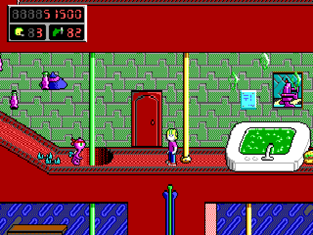

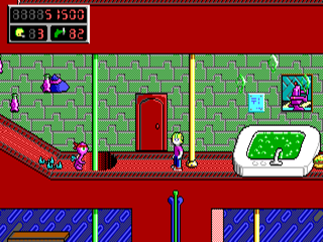

I've had this problem (if it is a problem) for a while now; I get some rows of pixels stretched vertically so that they're double the height. I've attached an image showing what I mean; the cursor in the Raptor menu will appear thicker in some places due to the pixel stretch.
Is this intentional, and is there a way to get rid of it?

Reply 1 of 19, by Mau1wurf1977
Yes this is because of aspect ratio and to do with pixels on CRT monitors being rectangles, whereas on LCDs they are square.
It's a basic Maths problem. The game on a CRT has 320 x 200 pixels, but the image is shown in a 4:3 aspect ratio.
On modern LCDs the only resolution that integer scales (no pixel getting stretched to take two pixels) is the 1600 x 1200 resolution (1920 x 1200 monitors can also do this).
You can minimize this effect by:
Having a very high resolution monitor with small dot pitch (27" 1440p for example)
or you can use render output openglnb which will smoothen out the image. It will look less sharp, but more consistent.

Reply 2 of 19, by KBABZ
Thanks for the help, although I realize that I should have specified that I only have this issue in windowed mode. In full screen it doesn't seem to matter what the render output is for me; the pixels are all the same height every time.
To give a bit of clarification, currently I'm taking screenshots of the DOS games I used to play as a kid so I can make some album art for their music. Sometimes, as is the case for Commander Keen, I need to take a 4:3 image and move elements around to fit into a 1:1 square. When doing this it's a lot easier to have DOSBox in windowed mode at 'actual size' rather than blown up to fit the screen in full screen mode. The offset however is that in windowed mode I get the rows of taller pixels, hence me asking how to change it above.

Reply 5 of 19, by KBABZ
The native resolution of my monitor is 1600x900. But it doesn't matter because the screenshot function worked! Dunno why I didn't think to try it before, although it makes me wonder why windowed DOSBox doesn't have an option to turn this vertical-pixel-CRT-stretch thing on and off.
As a 'for the record' thing, taking a screenshot with PrtScrn and cropping the window results in an image that is 320x240, meaning that windowed DOSBox effectively 'adds' an extra 40 pixels in height.

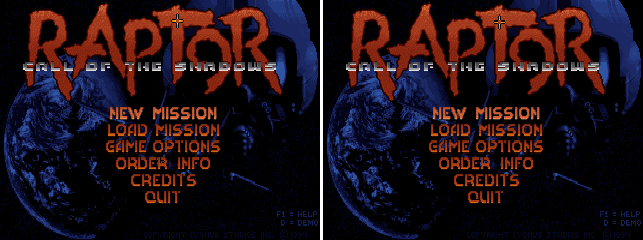

I'm puzzled by this. Can or can't DOS Box apply scaling algorithms to upscaled resolutions?
Could the 320x200 be upscaled 5x to 1600x1000, and then that 1600x1000 is the data which is used to do like a live bicubic (or some optimal nice looking algorithm) to stretch it into 1600x1200? Otherwise if that's all done at 640x400 or 320x200 the results are much poorer.
I've looked into this before but could never get satisfactory results. I have bought some CRTs recently in case there is no solution.

Reply 19 of 19, by VileR
There's a patch that adds a normal5x scaler. Rather CPU-hungry unfortunately, but does what you want if you add aspect=true and use an appropriate output renderer.
What truly baffles me is that graphics chipsets/drivers *still* don't offer a decent solution across the board for implementing this sort of behavior on the GPU.
