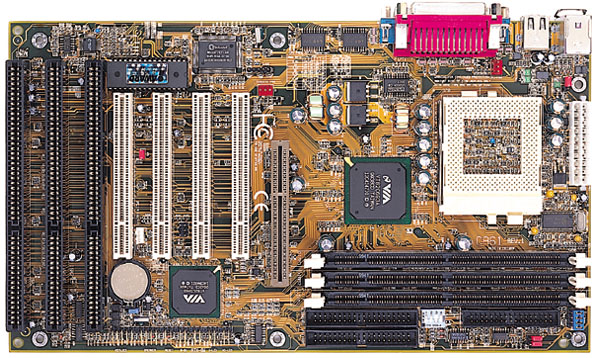

One of my favourites is the DFI CA61 Socket 370 Motherboard. Though, I'm not fond of the VIA Chipset on this board, and had some issues with RAM when FSB is run at 133MHz, but generally, I had good experience with it with all DOS games. Was using Coppermine 1GHz processor at that time.
Great for newer DOS games in pure DOS, and support for ISA slots - including flawless LAPC-I /MPU-401 Intelligent mode operation. Goes well with any Win9x iteration.
With enough RAM and fast processor, will be good enough for WinXP.
The issues with the RAM and FSB can be found here.
5943.jpg?
Edit : As a general rule when approaching hybrid builds, when it comes to pure DOS, I find it the situation to be most comfortable and most compatible to use 66MHz FSB, if the motherboard supports selecting it.
