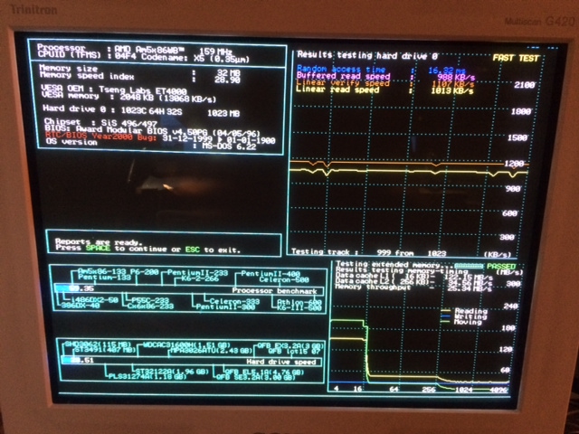

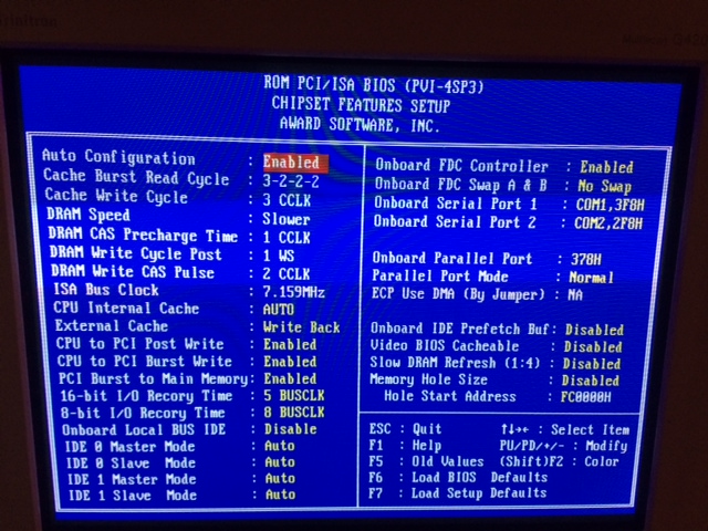

I just ran SST on my newly assembled ASUS PVI-486SP3 w/ AMD 5x86 @ 160MHZ, 32MB RAM, 256K L2 cache, and Adaptec ISA 1542 SCSI board.
It's the memory speeds that most concern me. See the shots:
163.87 KiB
475 views
My settings:
163.87 KiB
475 views
Thoughts? Thanks.

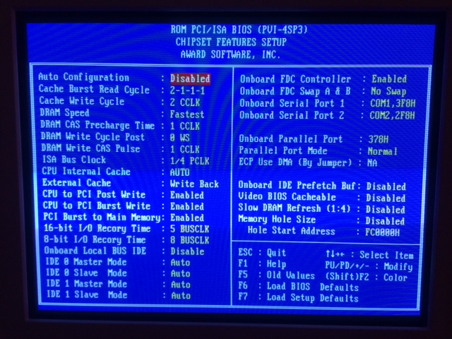

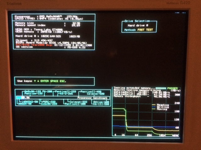

Ok, duh - disabled auto config and tweaked. Am I tweaked at the right settings here, or can I get more out of it? Thanks.
3DBench 1.0C went from 81.x to 92.8 w/ this new config.

Reply 2 of 10, by 5u3
Looks perfectly fine so far...
A few notes: You seem to use a different version of Speedsys (f.e.: it measures a "Memory speed index" instead of the usual "Memory bandwith").
I can't make out the version number in the top right corner because the image is not centered on the monitor, but the one we usually use is 4.78 (BTW, the program can save the results into a PCX image by pressing the R key).
There are still some things you could tweak for a bit more performance in some situations, but they come with the risk of an unstable system:
- Overclock the ISA bus even more: ISA Bus Clock: 1/3 PCLK (13.3 MHz instead of 10 MHz)
- Tighter ISA timings: 16-bit I/O Recovery Time: 2 BUSCLK, 8-bit I/O Recovery Time: 3 BUSCLK
- Spread out RAM refresh cycles: Slow DRAM Refresh: Enabled

So I went from 7.xMHz ISA to 1/4 bus (10MHz) and in Win95 the EtherLink III card was no longer working. So, I rolled back the ISA clock to 7.xMHz and still issues w/ the Ethernet card. Coincidental w/ something else? Can most cards handle 10MHz ISA? (40MHz bus.)
ISA cards I have: 3Com EtherLink III, GUS, Adaptec 1542.
Thanks...

Reply 7 of 10, by 5u3
May be coincidence, it should work with the fixed ISA clock. I've never used an ISA NIC on this board, however I had trouble finding a PCI NIC that would reliably work with the 40 MHz bus.
