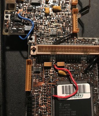

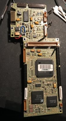

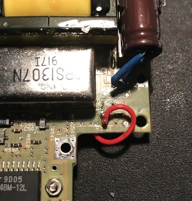

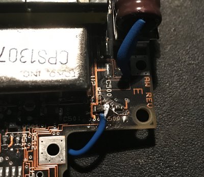

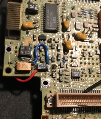

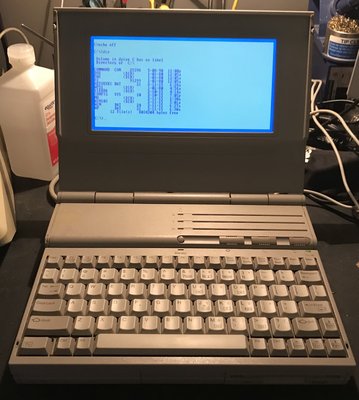

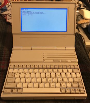

Here’s the LTE/286 that I repaired:

Reply 18 of 20, by Zack_H
Thanks everyone!
Yeah, these patch wires don’t exactly look the best, but I’m really not in the slightest concerned about it, as it’s hidden inside the machine 😀 Appreciate the suggestion though!

Very nice restoration, congrats!
This weekend I picked up the same machine from the flea market and of course it suffered from exactly the same problem: Leaking caps. After replacing them the situation got worse than better. Upon closer inspection I noticed that the electrolyte dissolved several tracks on the upper side of the IO board as well as one trace on the bottom where the liquid sipped through a via.
And these vias are exactly my issue: These are gone as well on the outside, so I cannot trace to where the signals were going (in case of vias that connect only to internal layers on one side).
I was able to fix most of the connections but one is giving me trouble: The one that you also fixed with a red patch wire, close to the multi-pin-connector between the two caps going to the big compaq IC. I traced the right side of the track (my via is still there) to reach exactly the big IC to where you wired your patch signal. The other side of the track is however so far gone (both sides of the via) that I have no way of measuring to where it originally connected. Do you still roughly remember where this track was going? Or maybe you have your LTE currently open are able to measure?
