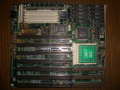

Here is my board, it seems I have the VRM so I guess I can run 3.3V CPUs without hassle! 😀
My board seems to work fine but the battery diddnt look very nice so I removed it.

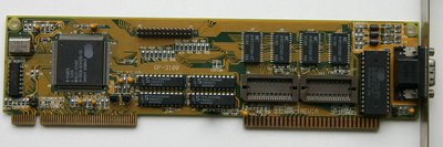

Replaced the GD5428 graphics card with a ... GD5428 graphics card. This one occupies less space inside the case and has SMD components. Also I noticed it has no visual glitches in mode-X, unlike the previous one. It came without the optional video memory, neither did it have the latest BIOS, so I took those from the previous card. What is still a little annoying is that the Windows "1024x768 60Hz hi-color" mode does not sync with my old TFT monitor, but 256 color mode does.

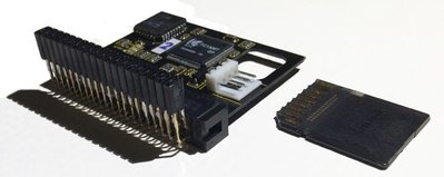

When mounted on the VLB I/O card, The IDE to SD-Card adapter was obstructing ISA slots. So I made a IDE 90-degree angle bracket.

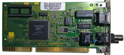

Got an ISA Ethernet card from 1997. In case I ever feel the need to connect this 486 to a network. It did not install properly in Windows 95 in the first try though. It started behaving better in DOS after disabling its ISA-PnP-mode with a 3COM tool. Still have to retry the Windows 95 installation in this Non-PnP-mode.
