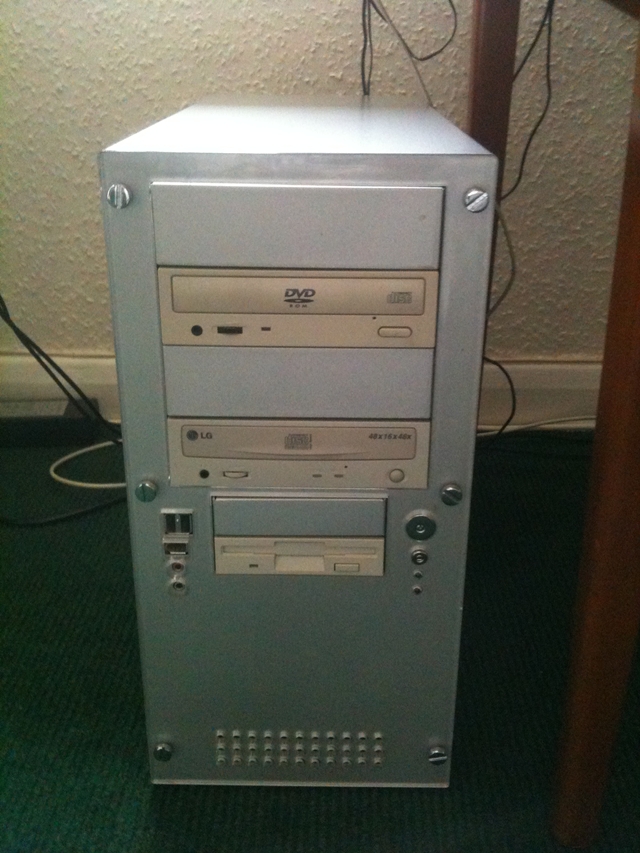

For the first time since the year 2000 I going to build a Intel skt 370 Coppermine machine, wish me luck!
Here are the parts I have so far:
This case, and optical drives and floppy drive:
file.php?mode=view&id=14426&sid=67956dd818e73e8000d06ce29058e107
Really solid and well made and from about the right age I think give or take a year or two.

Reply 1 of 22, by senrew
I have that exact same case. By any chance, would you know what the make/model are? The power button on mine is missing. I inherited the machine from a friend's dad but was going to replace the case. It's such a nice case though.
Halcyon: PC Chips M525, P100, 64MB, Millenium 1, Voodoo1, AWE64, DVD, Win95B
Reply 2 of 22, by BSA Starfire
Wish I could help, mine has no identification marks whatsoever. I believe it is from between 2000-2002 as mine had a dead Asus P4B board installed clearly by the original builder when i found it.

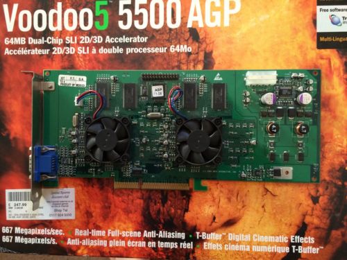

I splashed out a little this morning on eBay and have bought a 3DFX Voodoo 5 5500, always wanted one when they were new and now i finally have a machine i can use it with. Could someone recommend to me the best drivers for this for both 98 and XP?

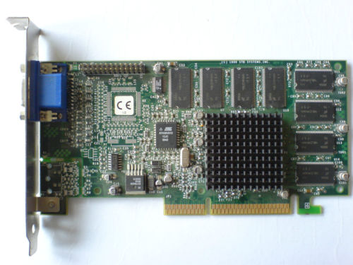

Both my 3DFX Voodoo cards arrived in the post today, Voodoo 3 2000 AGP & Voodoo 5 5500 AGP. Decided to start off with the 3.
Here's my 3Dmark2001 score:
file.php?mode=view&id=14425&sid=90102a1fba00589a760d6458aeb1309b
Unreal Gold and serious Sam 1& 2 are all running beautifully on this card, the Amiga sport drivers for XP work very well. Unreal particularly looks better on the 3DFX than on the GF2MX I was using previously. Going to enjoy the Voodoo 3 for a few days before i try out the 5 5500, after all I've waited 14 years already a few more days won't hurt 😉

My board is AGP-PRO 3.3v socket, mahap you have a different revision of the board? I have had no problems with either the soundblaster or the network. just installed the 3DFX Voodoo5 5500, it's working great. I don't have a FX5200, but have run a Geforce 2MX 400 with no issues at all.

He are some photo's of the machine with the Voodoo 5 installed, sorry they are not great, mobile phone camera is all I have.
