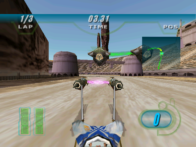

So I'm trying to run Star Wars Episode 1 Racer on a few XP machines. The game runs swimmingly except that there's a big white layer covering the screen just ahead of the pod so you can't actually see anything as you race. I've scoured the internet and the only fixes I can find point to a patch on the LucasArts FTP which is now down. Does anybody else have this archived somewhere?

It's weird, it's like a big white flat polygon face that lies just in front of the camera. I can see the pod and the ground directly beneath it but anything further is blocked by this giant white layer. I'd have thought it was the HUD but it moves and rotates with the pod in whatever direction it's facing and the HUD doesn't move.

Reply 10 of 69, by Bladeforce
Well I got the game running in Wine without graphic glitches and just using the exe I posted earlier. Not much help but at least you know it is possible to run still!
