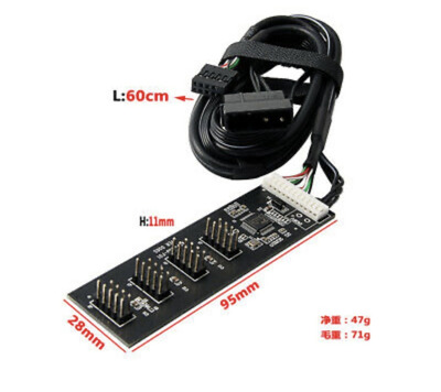

Reply 108 of 312, by Sphere478
After trying this and that with usb 2.0 and 3.0 cards and for reasons of limited pci slots and the huge issue of the usb 2.0 cards slowing down the system, I’ve come to the surprising conclusion that to heck with them, add a hub to the onboard usb 1.1.
I’ve put these in both of my retro systems, one at first then the other after being so impressed with the first.
Highly recommend them for anyone looking into this topic

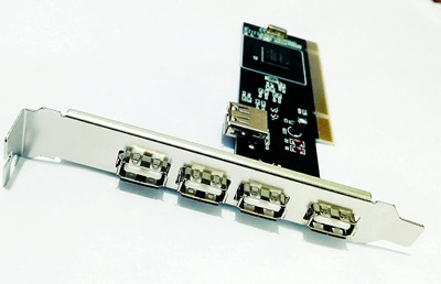

Reply 110 of 312, by lordmogul
In my Socket 370 system (i815 chipset, 98SE/XP dual boot) I'm running a USB 2.0/IDE/SATa combo card with VIA VT6214L and VT6421A chips. No idea which one das what, but so far I had no issues using the USB and IDE ports on it, and drivers for 98 SE are available.
Looks like this (picture from the internet as I can't get the card out right now.)
Not sure about the quality of the card, I got it only to not be limited to USB 1 speeds when moving stuff to the machine, and by now I can just throw stuff over network, but still, not the worst idea.

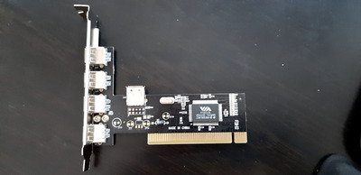

Reply 111 of 312, by octopus
I have this generic USB 2.0 PCI card, which sadly won't work on my FIC PA-2005.
133.29 KiB
2207 views
Last week my father in law gave me his old pc to tinker with. I was delighted to find another USB 2.0 PCI card inside!
Surely this one from a 2002 pc would work, no?
Well, guess what: it's the exact same VIA chipset from my recently bought one.
19 years in between, what are the odds..
