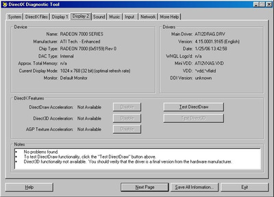

Thanks for this comment. I am facing exactly the same issue (Direct3D not available on dxdiag). But I have already installed Dx9.0c, and it doesn't let me install "7.0_directx7.exe" now. Do you know any solution ?
Reply 11 of 16, by bazingaa
Warlord wrote on 2023-01-05, 03:33:
if you want dx7 and not 9 the only way is reinstall 98se install dx7 and dont install dx9.

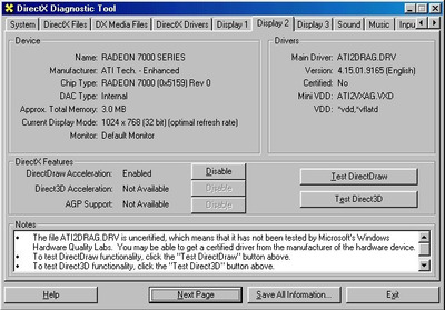

Thanks, I thought so. But I have found a tool called"DirectX Buster" ( https://www.majorgeeks.com/files/details/directx_buster.html ).
I was able to remove DX9c with that and install DirectX 7. Then DirectDraw is enabled but still Direct3D is not available.
I also tried with DirectX 8, then even DirectDraw was not available similar to DX9. So I reverted back to DirectX7
Screenshots are attached with more details. I am using ATI Radeon 7000 drivers from AMD itself ( https://www2.ati.com/drivers/6-2_wme_dd_cp_30314.exe )

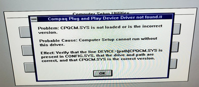

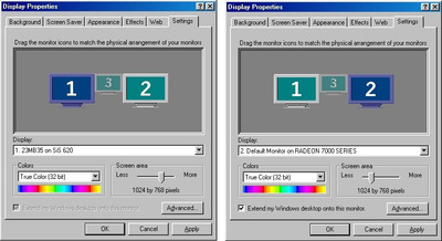

My case is little bit complex, I can't disable SiS620 4MB IGP (running at AGP 2x), so Radeon 7000 is a PCI . So, both cards are working now with multiple displays (Screenshot).
There is no AGP slot on board (Compaq OEM FIC C31-A with AMI BIOS) and can't access to BIOS to disable IGP (unlike with retail version of the same motherboard with AWARD BIOS).
I tried various SOFTPAQs (ex: SP15674 , SP8126, SP8126 etc) with "Computer Setup" but all said unsupported system or "CPQCM.SYS is not loaded or is the incorrect version" (Screenshot).
I even tried to crossflash retail AWARD BIOS UA412 as mentioned in https://www.elhvb.com/ctechinfo/model/CE31-A/CE31-A.php to get full BIOS setup.
But it bricked the board, and I had to reflash Compaq OEM AMIBIOS UE6137 to SST29EE020 BIOS chip with an Arduino as an EEPROM programmer.

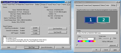

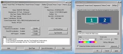

I found a simple solution to disable onboard card. Placed RAM on 2nd slot instead of 1st slot. It disabled onboard AGP card and I can now use PCI Radeon 7000 64MB.
Dual 1080p displays on glorious Win98 with 3D. 😀
    61.55 KiB
    1018 views
    DirectX 7 Status
    107.06 KiB
    1018 views
    Monitor 1 @ 1080p DVI
