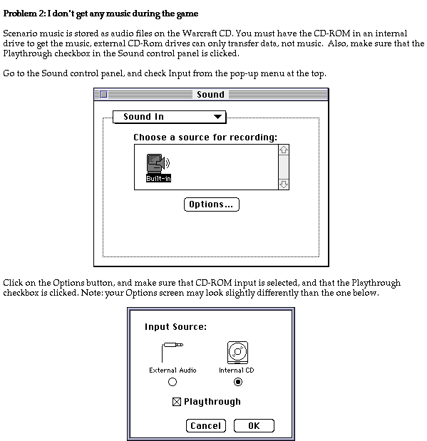

*I just read the troubleshooting section of the game manual and I found out that the lack of CD audio in the game may be due to the fact that when you have System 7 installed and you go into 'Apple Logo' >> 'Control Panels' >> 'Sound' >> 'Sound In', you should see 'Built In' as one of the sources available for recording. You should also find an 'Options' button. By clicking on it, you should be able to select 'Internal CD' as your input source, and check the 'Playthrough' checkbox. See this screenshot taken from the manual:
15.52 KiB
18369 views

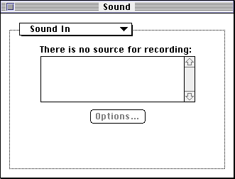

However, this is what I saw when I accessed the 'Sound' menu and selected 'Sound In' from the drop-down list:
2.82 KiB
18369 views

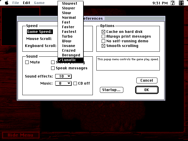

Haven't played either version long, but one immediately apparent difference is that the Mac version has spoken campaign introductions while the DOS version is text only.

I found a fix for the game speed issues. You can use an experimental build of QEMU to run the game. Check out this YouTube video for proof. The audio CD tracks were added post-recording. (Btw, apologies for my abysmal gaming skills.)
The Macintosh version is different from the MS-DOS release in that it runs in 640x480 resolution by default, and it has audio CD tracks. Also, it comes with some extra options, and the 'lasso' method of selecting troops works without you having to hold the CTRL key. However, the hi-res graphics are a bit disappointing, as they look like they were resized from 320x240 to 640x480 with an algorithm that blurs the image somewhat.
