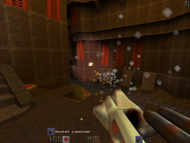

So I just got a pair of Voodoo 2 cards off Ebay, two 12MB STB cards in SLI. I haven't been able to find out anything about this so I'm hoping someone here knows what's going on.
The cards are great. They play the two games I've tried them with fine, except for this one thing. There's these horizontal lines showing up everywhere. As the title says, these aren't black lines from SLI. I've tested the cards together, and both individually, and every time I get the same thing, so it's definitely not an SLI issue if only one card does it, and in my case they both do.
This is what it looks like. (pics from Tomb Raider using the Voodoo Rush patch with the audio patch that someone made so I can hear the music that was left out)

I've used the latest reference drivers and the fastvoodoo drivers, both have the same result. I've tried this with Tomb Raider and Quake 2 demo. I've noticed on Quake 2, however, that if I turn up the resolution, the lines become less noticeable, if they're even there.
I've tried messing with the settings on the cards but they don't seem to make any difference. I've reseated the cards multiple times, since I had to swap them out to test them.

Reply 1 of 39, by leileilol
Intended feature, it's the 4x1 DAC filter smoothing out the dithering to approximate a 24-bit picture. Most older Glide games activate this. Direct3D and OpenGL (ICD - not MiniGL) games don't activate this.

Voodoo Graphics cards always had the characteristic look of blurring 4 pixels to the right per 1 vertical line.
If your voodoo is showing these 'lines' then there is nothing wrong with it 😀

Alright, thanks for your responses. I'm not sure if I've noticed any blurring for vertical lines, but that's good to know. I've only noticed these horizontal lines having different colors / brightness. I had no idea these cards did that. I lack a CRT so I don't have a way to see what it would look like on there. I assume it would be the same as your case; not noticing it at all.

Actually, when I tested Quake2 demo, I didn't notice the lines on the HUD elements, but the 3D environment had it. (notably, the health icon looked perfectly normal as with the numbers from what I could tell)

Reply 12 of 39, by leileilol
They should look blurry once you enter the menu as they're dimmed.
