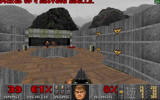

  • Use the super shotgun in Doom 1, with parameter "-ssg -file ssg.wad", combined with "-unlock" in case of shareware.
  • Parameters "-stdvid" and "-bestvid" for benchmarking under comparable game settings.
  • FPS counter option (run a timedemo to unlock the 35 FPS framerate cap).

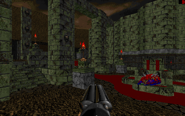

I tried the official "No Rest for the Living" Xbox-Arcade Doom II addon with both MBF and the original Doom II exe. Using the command line parameters "-iwad doom2.wad -file nerve.wad".
Surprisingly even Doom II loads the maps, but it has visual corruption in complex scenes and tends to crash. MBF runs NRFTL without problems so far!
Framerate is rather low on a 486 (100MHz Cx5x86) in stock video mode. For the screenshot the game was switched to 640x400, showing a part of Map 'MAS04'. Obviously the amount of detail in this addon far exceeds the stock iwads.

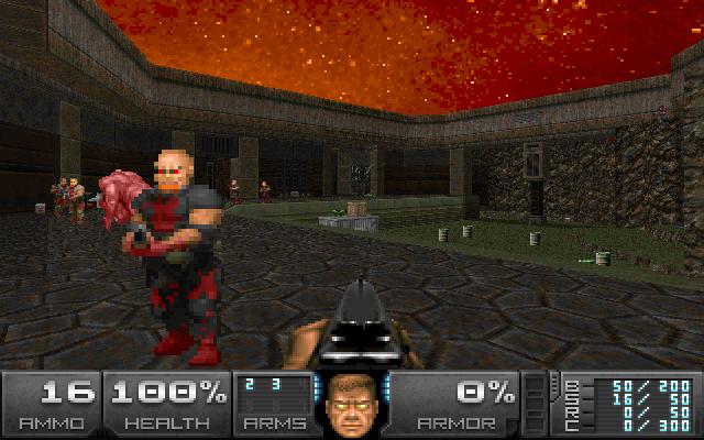

leileilol wrote:
Have you tried BTSX on it?
Just tried it like this: "MBF.EXE -iwad doom2.wad -file btsx_e1.wad -dehlump btsx_e1.deh". As far as I can see everything is working.
