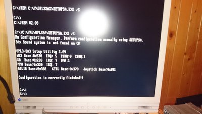

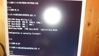

I tried OPL3-SA for my 3D-XG in version v2.11 and v2.09. The sound card was detected correctly but no sound in every game. OPL3-SA is not backward compatible with 3D-XG.
When I run it with 3DXGINIT.EXE everything works. Every game with SBPRO 2.0 support works exept Wolfenstein 3-D. The sound always goes from both channels together. Any idea?
I have tried version 1.1 and 1.4.
I tried to work the Wolfenstein 3-D with stereo support with these sound cards below and no success too. The sound always goes from both channels together.

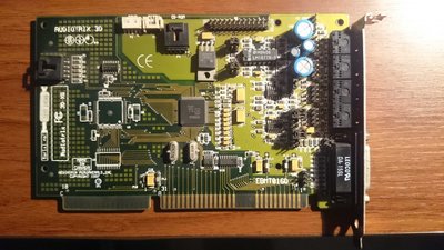

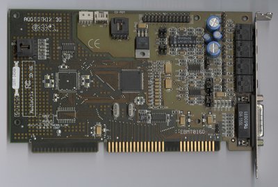

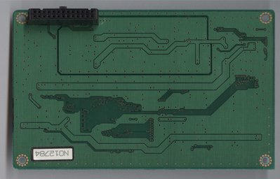

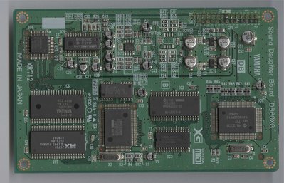

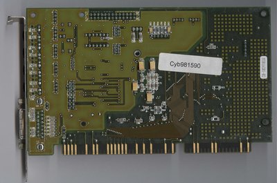

And because I have never found a better picture of 3D-XG in the internet I scanned my sound card with DB60XG.
Reply 14 of 23, by Cloudschatze
By default, the 3D-XG routes the output from the YMF715E through the A/D inputs of the DB60XG. This requires proper SysEx initialization of the DB60XG's A/D parts. Mediatrix' INIT3DXG utility provides this functionality, whereas the SETUPSA utility does not, resulting in the behavior you've experienced.
I would suggest reconfiguring the output routing of the 3D-XG if you want to use SETUPSA, separating the YMF715E output from the DB60XG entirely.
When I run it with 3DXGINIT.EXE everything works. Every game with SBPRO 2.0 support works exept Wolfenstein 3-D. The sound always goes from both channels together. Any idea?.
This behavior is the result of a volume-level quirk of the YMF715E, requiring specific mixer settings in order for the SB volume control to have any effect. Refer to this thread for details.

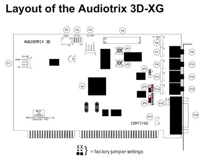

I discovered some interesting jumpers according to the manual on 3D-XG which are important when you do not use an original DB60XG with analog inputs. With this layout of jumpers you reroute SFX/OPL signals direct on LINE-OUT and amplified SPEAKER-OUT. Now my 3D-XG is not deaf 😀 and you can use standard OPL3-SA setup utility like v2.11! You can use whatever daughter boards you want with 3D-XG. It will works too.

Reply 16 of 23, by darry
I am somewhat confused as to why JP1 and JP2 do not both also need to be changed to 1-2 and 5-6. Do they only apply to SPEAKER-OUT ?
EDIT : JP1 and JP2 blocks do seem to indeed be for amplified out only . If I remove both of them, nothing comes out of the amplified out, but the line-out keeps working.
Are you sure both line-out and speaker out work with your jumper settings ?
I plan on using an Audiotrix 3D XG (probably without the daughterboard ) and just realized how confusing (to me) the signal routing and jumper settings are in the manual .

Reply 18 of 23, by Rabanik
Yes. Check the picture. I have been using this setting with my Roland SCB-55. It is a daughter board without analog inputs. Every DB works on 3D-XG.
