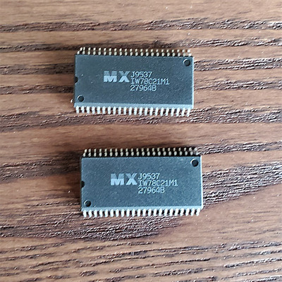

Got a pleasant surprise today when my Utsource order showed up. This is despite the tracking status on their site still showing as "Waiting for shipment".
This just proves you can't always trust online tracking statuses.
    114.43 KiB

Reply 2903 of 3172, by Shponglefan
Sunoo wrote on 2022-05-02, 15:29:
Lucky! You may have scored the last ones in their inventory.
That may very well be the case.
I'm surprised their web site still lists over 30k in stock of these. Guess those numbers don't mean much either.
