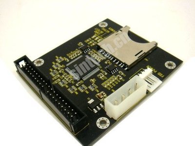

I recently received an adapter that converts SD cards and passes them as IDE hard drives to the host motherboard.
Attached picture is my model.
I was able to detect it as a primary hard disk, format it, and install MS-DOS 6.22 on it.
However when comes time to boot from the SD/IDE hard disk, it just stalls for a long time, then spits the well-known 'DISK BOOT FAILURE, INSERT SYSTEM DISK AND PRESS ENTER'.
I'm wondering if there's some manipulation I have to do, either on the SD card, or in the BIOS, to allow booting from this device. Is there even a boot record/sector on SD cards?
Worth mentioning is that the DOS installation returned no errors and seemingly no incompatibilities.
When opened on my main PC on Windows 7, the SD card reports being formatted in FAT (which seems appropriate). File structure seems also normal for a clean DOS install.
Here's what I tried
0. Reinstalling a few times from different MS-DOS disks. No difference. Installing on a real hard drive works perfectly and creates a working bootable disk.
1. Changing the IDE connector from the middle to the end plug on the IDE cable and back. Still gets recognized on the Master channel no matter what.
2. Letting the disk be auto-detected on the fly. Or auto-detected in the BIOS options. Or setting values manually. This changes how the computer perceives the simulated disk (sometimes as LBA, sometimes as CHS, sometimes as LARGE, with varying sizes) but does not prevent the infinite freeze and/or DISK BOOT FAILURE message.
Any ideas on some obvious things I might have missed?

Where (on what kind of computer) are you trying to use it and what SD size are you using? Maybe you're hitting some kind of BIOS limit. Also check that the adapter is correctly powered (connected to PSU and jumpers correctly set). Try with your older (and smaller) SD card, they tend to be more stable than newer cards.
An remember that maybe the problem is in your card. Check the write protection tab (although it should have failed when installing), and check your card with f3 (linux) or h2test.
- The PC -
Computer : A Pentium II 333Mhz
Motherboard : ACCORP 6LX/EX68 SLOT 1
The BIOS is from 1999, from Award Modular, and accepts very large HDDs with auto-detection
- The Adapter -
The adapter powers on correctly and has LEDs to confirm it; it uses standard Molex or FDD connector
There are no jumpers on this thing
- The SD Card -
My original try was a 2GB card, that was well within the specs for FAT. Gave the 'DISK BOOT FAILURE' error.
I also tried a 16MB card, that was simply not detected by the adapter.
I verified the write-protect option, all my cards are write-enabled.
Installed MS-DOS without issues on a 256MB card. Gave me a 'Missing operating system' error instead.
Tested the 256MB card with h2testw without issues.
chinny22 wrote:
its not something simple like missing the sys files?
- The Install Disks -
I'm using a full installation, not an upgrade, of MS-DOS 6.22
Doing that same installation on a formatted hard disk works flawlessly
- The Data -
The two file structures (on the 2Gb and the 256Mb cards) seem identical :
[DOS]
AUTOEXEC.BAT
COMMAND.COM
CONFIG.SYS
IO.SYS
MSDOS.SYS
WINA20.386
Now since using different SD cards gave different results, I'm going to test with more and report back later today. Thank you both 😀

Reply 4 of 13, by Jepael
The original partitioning could use different geometry from your BIOS. Dos uses CHS anyway, not LBA, and the way the BIOS maps LBA to CHS may differ what from what kind of partition table the card manufacturer thought it would be nice to use as CHS parameters.
I'd try to zero out the partition table, and use LBA to get up to 2GB partitions (or then just force CHS parameters for 512MB support). Perhaps delete all partitions with fdisk, reboot, run "fdisk /MBR" to rewrite MBR code and whatever parameters, reboot, and then create a single DOS partition. Then both your BIOS and the partition table on card should use the same emulated CHS geometry.
- I extended my tests to five cards : 16mb, 256mb, 2gb (no-name), 2gb (Sandisk) and 4gb.
- I have tried formatting the cards from my main PC (via USB adapter) and directly in the retro-PC (both with the DOS install, and independently with a boot disk).
- I have watched this gentlemen's video https://www.youtube.com/watch?v=G26cRjrt5Mg, who seemingly had the exact same problem as I did.
- I have stopped using auto-detection in the bios for the IDE hard drive (which often miscalculated the Cylinder, Head, etc.) and am entering specific values.
- The specific values make the hard drive detected and recognized every time (that got rid of the 'DISK BOOT FAILURE' error).
- As a result, the disk uses CHS now, for all the five cards.
- 16mb still not recognized by the adapter. 256mb and 2gb cards are detected. 4gb gives problems with FDISK because it's too large apparently.
Matth79 wrote:
Can think of a couple of things, reformat card with SDformatter to ensure it's got a standard format.
Davros wrote:
is your disk fat32 or fat16 ?
- The cards have been formatted as FAT16 both on my main PC and with a DOS boot disk on the retro machine.
- I have not tested SDformatter yet, but will try soon.
philscomputerlab wrote:
from a boot disk, and after having installed MS-DOS and all of that try:
sys c:
fdisk /mbr
- This worked, only once, on the 256mb card. But DOS didn't like it and there were apparently unknown commands in the CONFIG.SYS that were skipped.
- My boot disk was created with the same version of DOS that I'm installing, so I don't know how/why commands in CONFIG.SYS could be unknown or unrecognized.
- When I did try to reproduce this result a second time (install DOS, SYS C:, FDISK /MBR) it didn't work and gives me an 'Operating system not found'.
Harekiet wrote:
I have a similar problem with an sd to compact flash converter and then using the compact flash as IDE. I can access it and read/write files to it but can't seem to boot from it. Wonder if sd cards have some weird write protection on the first sector. Haven't checked yet if there's an actual valid bootsector there.
Jepael wrote:
They don't have a weird write protection, but when fiddling with anything that may touch the partition table, it is possible that the card ends up being looking like a floppy (no master boot sector like fixed hard drives, starts with just partition boot sector like removable floppies).
- I have the same issue as Harekiet. If I boot from the SD Card, it says 'Operating system not found'.
- It gives 'Operating system not found' even if MS-DOS is installed on the disk. And even after a SYS C: + FDISK /MBR.
- If I boot from a boot disk, then access (write, read) files on the SD Card, it works flawlessly, as a second drive.
- There seems to be an issue with the MBR on SD cards... It gets written, but does not seem to hold the changes. At least not consistently.
- When using SCANDISK on the drive, it tells me that the MBR and MBR safety copy are not identical, which reinforces my belief that MBR on SD Card doesn't work as intended.
Well that's it for now. Will continue testing stuff then report back.

Reply 11 of 13, by AvalonH
I had the same problem with a 32GB card.
I switched to Dos 7.1 (from a win98se cd). Partitioned and formatted with the updated Fdisk (KB263044) and formatted as FAT32(x). This made sure that LBA was being used and it booted as the primary hard disk even with (removable disk status). There seems to be a problem using CHS when booting devices partitioned as 'removable drvies' that only contain a partition boot sector (no mbr). This applies to USB sticks as well.
The other work around I later used was to force it as a 'fixed disk' and then when partitioned it would created a mbr with a partition table (same as regular internal hard disk). This method then boots with any adaptor and any card I have used (compact flash and SD cards).

Reply 12 of 13, by gerwin
I boot from Sandisk 2GB and 4GB SD cards on systems ranging from a 486 VLB to a 1400MHz Pentium III. The SD adapters should have the same chipset as the one shown in the first post.
The 486 was not cooperating at first. IIRC with the original BIOS I had to manually enter Disk Parameters. A later modded BIOS fixed it alltogether. Also IIRC it mattered wheter or not I formatted and 'sys'd it from the 486 itself or while the SD Card was in another PC.
Reply 13 of 13, by chrisNova777
+1 for fdisk /mbr
just got my 256Mb SD card booting! thank you phil
