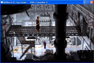

Reply 5 of 22, by Jiri
BASS started fine (the intro and factory scene) with the official stable release of DOSBox 0.61 (no tweaks in the configfile) on my computer with Windows XP. It worked with a standard install procedure + Sound Blaster/Adlib for sound. The directory with SKY.BAT file was created and the file PHQGHUME.AYL appeared in the mounted games directory (root).
It worked even without the standard installation, running SKY.EXE from the CD instead of INSTALL.EXE seems to be sufficient. The game created automatically STEELSKY directory for savegames and the file PHQGHUME.AYL and immediately started with sound and all. My CD version is from the European Union with the Revolution/Virgin logos on the box.

Reply 14 of 22, by Dark Knight ez
sorry for reviving an old topic like this, but...
i got it all to work!
first of all, i copied all the data files to my harddrive...
after doing that, i installed the game.
i looked at the newly created .BAT file and it said something strange, (and upon execution it made dosbox crash) but it seemed as if it tried to open sky.exe with the newly created .CFG file as tag.
then i copied the .CFG file to the directory of where i copied the data files...
then running sky.exe like this "SKY.EXE SKY.CFG" it runs beautifully!
i mean, the entire intro works... speeches... everything.
i guess the install was just corrupted... well, the .BAT file it created certainly was. it created this:
C:
SKY CFG=C:\SKY2
can someone email me their own install-files (INSTALL.EXE and INSTALL)?
i'm guessing this is the only thing wrong with my CD... seeing how it created a faulty SKY.BAT file.
email is: ssstolk _at_ hotmail _dot_ com
thanks in advance.
