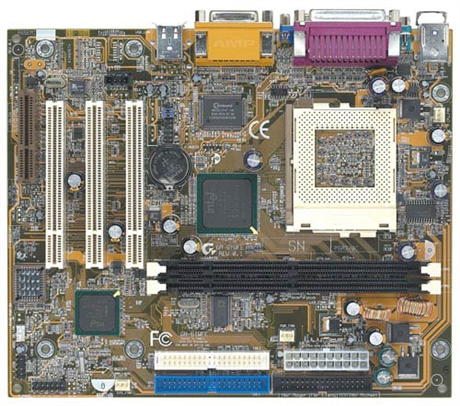

Okay, so a small update: a guy on a South African forum messaged me telling me that he has a Socket 370 motherboard and CPU I might be interested in. He has a Gigabyte GA-6IWFE and an Intel Celeron 1100A. The motherboard is mATX with 3 PCI slots and an Intel i810 chipset. He wants roughly $20 for it. Is it worth it or should I keep looking?
Some links:
Image of the motherboard:
Reply 17 of 48, by F2bnp
I used to have an OEM i815 mATX board from a Compaq Deskpro EX, which was a pretty solid board (it had an AGP port as well). I think you should look into those instead of i810 if you specifically want mATX.
Reply 18 of 48, by Skyscraper
That board looks a bit boring but if you do not need AGP then why not?
This i810 board probably performs like other i810 boards. If its worth the price is a tricky question. The Celeron 1100A is a rather nice CPU to use with BX/i815 chipset motherboards, I ran one at 11*133 for a while. You need a modded slotket (or a rare one with Tualatin support) to run it in a slot1 motherboard though.
Reply 19 of 48, by obobskivich
The lack of AGP may or may not be a hindrance; there's plenty of neat enough PCI cards. One thing I'm noticing on that Gigabyte though, is the CPU socket looks relatively clear of obstructions, so you may have decent luck with larger heatsinks.
