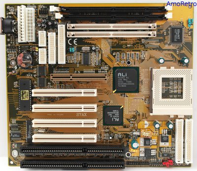

Hello everyone! In my last batch of old PC's I picked up a Commate S7AX Super Socket 7 witch has documented K6-III and 512MB SDRAM support. It's a baby AT format motherboard with an ALi Alladin V chipset.
This thing gave me quite a few headaches, refusing to run my K6-2 450 test CPU at it's rated speed despite properly made jumper settings - same for my K6-III 450 - it would run the K6-2 at 350MHz and the K6-III at 300. The issue seems to have gone away after a few bios resets, but then the board refused to boot. It would hang at "Updating ESCD". Fixed that as well trough BIOS.
Right now I'm trying to get the board to run with a 40GB maxtor HDD, but it hangs when attempting to detect the drive. Same story for a 30GB Seagate. It seems to only detect 20GB or smaller drives. I've found several google links to a BIOS update witch allows support for drives up to 160GB, but all the links are dead.
Right now I'm running win98 se on it via a CF to IDE adapter, but the CF cards I have are pretty slow (233x) and all systems I ran off them have "freeze" periods.
Does anyone have one of these things? Do you know where I could get the latest bios for it? (VER 3.0 is the latest apparently) .

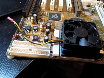

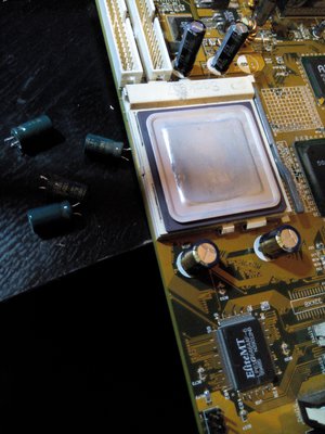

Below are some pictures of the cap swap. Replaced the board's caps with two 6.3v 1000uf panasonic caps and two 6.3v 1500uf rubicons. 3 of the 4 caps I replaced tested good. The 4th one was within tolerance.

What about the last cap near the ISA slot? I think it's part of the VRM. Looks like the two tall caps are Panasonic FR series and the two short ones are Panasonic FC. FR might qualify as low ESR, but FC is closer to a general purpose capacitor in terms of ESR. It might be adequate here, but if you can get a brand and series off the old cap, you can reference the specs in their datasheet.
Also, when you say "tested good", was the ESR within spec?
Linkworld uses Fuhjyyu brand capacitors (Garbage, and almost certainly out of spec in a PSU of that age). I'd be curious to see a picture of the innards.

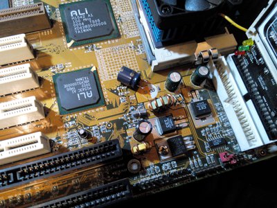

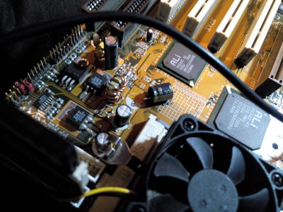

After doing some research on socket 7 power circuitry, I replaced (again) the capacitor next to the ISA slots with a 1500uf cap over the 1000uf one that the board originally came with, and ADDED a 3rd 1000uf capacitor (a panasonic one) next to the two green samxons under the CPU socket.

As you can see in the first two pictures, the board doesn't come with a 3rd cap and there was no evidence that a 3rd capacitor was ever installed there. I decided to add it, and replace the 1k uf ISA one with a 1,5k uf one after looking at pictures of similar boards by other manufacturers - Lucky Tech Ali Alladin baby AT board for example - witch has a very similar layout but uses more capacitors.

Good job...
Samxon has reliable series such as GT, RS, GD, GC, GA, but the green Samxon caps are probably "GF" series, which are a defective series and should be replaced on sight.
Adding the third Panasonic cap probably picked up the slack for the two failed Samxon caps, but because it's now tasked with excess ripple, it might get stressed. What I would do is to go ahead and replace both of them with two of the same Panasonic FC 1500uF caps.
