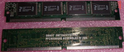

I think that SIMM is flipped the wrong way to see them.
Pins 67-70 (Presence Detect 1/2/3/4):
http://pinouts.ru/Memory/Simm72_pinout.shtml
Those pins are at the left in your picture, but the jumpers are probably connected on the other side of the PCB.
A couple examples from eBay, not my pictures. Configuration jumpers are at upper right:
76.65 KiB
3216 views
from ebay
29.36 KiB
3216 views
from ebay
I found a couple SIMMs and checked the resistance across the closed jumpers, and they were 0 ohms. I thought they'd use a weak pulldown resistor but apparently not, the signals are dead shorted to ground.

The SIMM I showed is one-sided, there are no elements on the other side.
If you are correct, then where are those jumpers on all the 30-pin modules? Why are there sticks with no jumpers at all?
